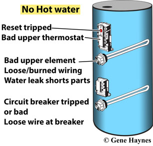

There's no way the tank can be empty. Water goes in the top and out the top. basod and Stihl Livin are onto something if it's a reduced pressure problem. If it's a temperature problem I'm saying bottom element or dip tube. See if there is a reset button on the elements.
