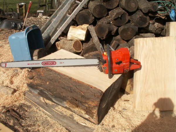

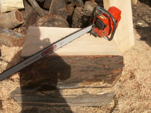

    I keep a 28" on the 288XPW,even when cutting 12"- 20" stuff.Sure saves on the back not having to bend over near as much.
    That stays on there almost exclusively,except for the rare occasions when needing a longer bar.
    Like yesterday when I finally got around to roughing out that monster 36" Honey Locust that had sat since August 2012.A few shallow cracks,half the bark had started to rot & fall off & both ends were dark,but after the first outer slab was removed,it really showed how wet it still was inside.
