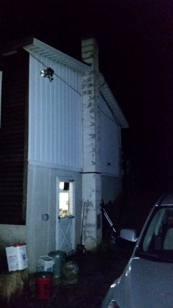

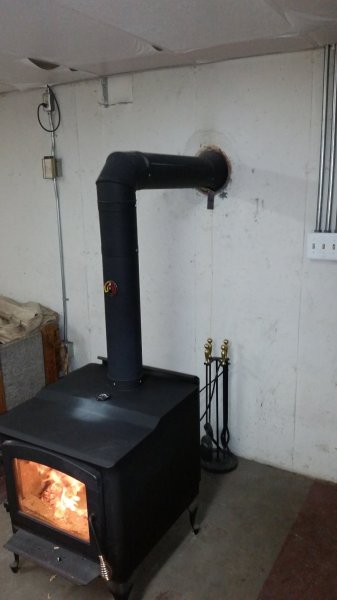

    Wow this site is fast. The pipe exits the stove with one piece of pipe up to a 90 then another piece of pipe to the cement wall where it exits the wall directly into a 25-30' chimney with a rain cap on it. The wood was delivered in sticks last March 2015 cut in march split in August and stacked in September 2015. It has always done this. I have wood that is 2 years old been sitting in the house and it does the same thing too.

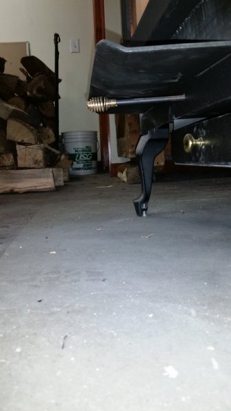

    I don't have a moisture meter which stinks wish I did. If I open the damper too much she runs at temps of 750-800 that is scary in my opinion. I usually put the tip of the damper rod not the spring, the black tipped rod right where the ash tray lips up at what looks to be a 45° angle.

    That's a 30' chimney? Looks 18-20' to me...still should be OK though.
