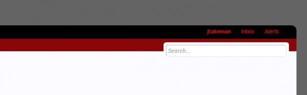

    First of all, is there a "Search" option on these forums? Maybe I can't see it.....:bug:

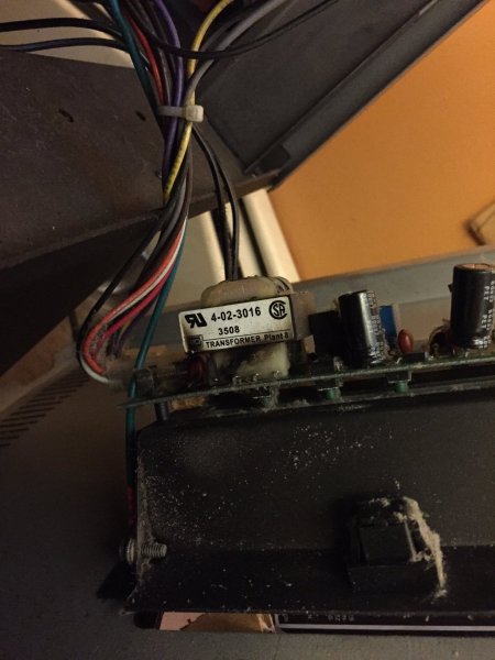

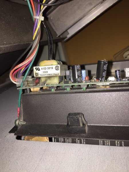

    The heat up/down buttons have become hard to press, such that I pressed so hard that it created a short circuit but thank God nothing happened and the unit seems to still operate. The below pics show the little transformer a bit black with the short circuit.
    I removed the side panel and I can see that this side of the board is a bit away from the button, sort of warp a little bit, I unplugged the unit and then pressed that side of the board firmly to be close to the button and that seemed to be clicking much better.
    I can remove the board easy, and then try to re-shape it a bit but I am afraid to brake any of the soldered components.
    Take a look at these 2 pics.
    Should I take the chance, remove it and bend it straight?

    I would not try to reshape the board, you may damage it. I'd try to be a bit imaginative and try to secure the board so that it's held flat - maybe some wire ties, etc., strategically placed.

    Upper right corner under your screen name is the search bar. A bit tough to see.......

    yeah, that search is like begging not to be bothered.....lol

    My plan with the board is to spray cleaner, like WD40, around the push buttons from the back and clean them up.

    Loosen the screws holding the board, but don't have to remove.....just enough to lift the board slightly. Try putting 2-3 layers of masking or electrical tape on each button to "tighten up" the space?

    I think that is one of the options.... right now I just removed the side panel again, although I lubed the buttons a bit, the problem is that the buttons are a bit far from the oard, if IK press the board gently on that side in the direction of the buttons then I can press the buttons and the clicking is heard.
    So, I am going to try electrical tape to build that up a tiny bit, and see what happens.

    If the buttons work properly when pressed, then yes either shimming the board or adding to the buttons would likely help.
    The bigger question is was it always like this (probably not) and how did it warp? Did the transformer overheat for some reason? If so, is that an issue waiting to happen that should be corrected?

    I shimmed it last night by placing a small cut out from a credit card plastic, worked really good so far.
    How did it warp? Well, not sure but maybe because I was pushing very hard on the buttons of the control panel and with time the board itself kept going away, the warp is very subbtle but enough that the green little pins are away of the metal (where you press the buttons).
    The fuse never got blown out even there was a shot circuit a few days ago.
