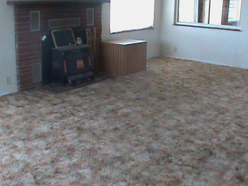

    Jeff, we threw in the towel on the old Blaze King. Too much to do to, and not enough man-power/time or expertice. I talked with an acquaintance that has a friend that needs a stove. We shall see, I plan on sending the $200 new cat with it, so I will only send with someone that can actually use it. Thank you for the options to explore, its dizzying googling for a good stove.
    I doubt there is a new liner guessing from condition of the rest of the house when we bought it. There is double walled pipe ontop of the chimney, we are wondering if the entire chimney length is the same? Even if there is doublewall pipe all the way up we are going to get a camera down it (now that we saw the condition of the cat:hair:) We need to actually get in there and see, but alot of insert measurements look promising. The newer fireboxes do not seem as deep as this one, but this will not be our primary heat source either, probably only on extremely cold or extremely windy winter days. blaze king.jpg
    Though DH love a real fire :fire: Yes, it seems like a large faceplate, ~45" x 34"H. We will also have to figure something out for the blower vent inserts in the wall:doh:

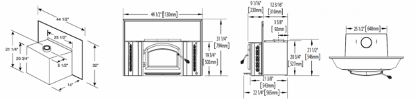

    Screen-Shot-2014-02-28-at-12.18.53-PM-1024x248.png We will need some creative thinking for this one, Napolean1402, faceplate ~2" short.

    FP is 24 x 36 x 18 deep.
