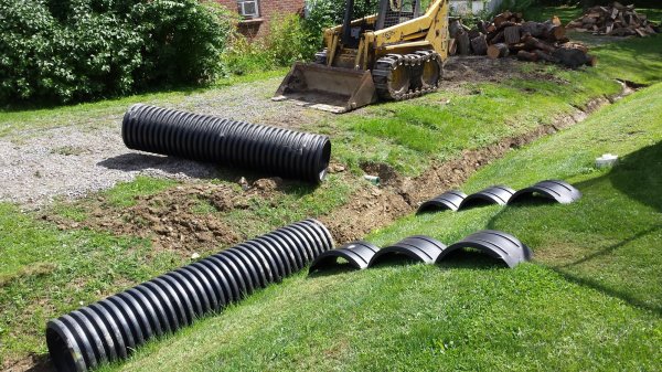

    This ditch has been scraped out and graded several times over the years, from sediment that comes off of the farm. And it has a bed of shale in it already, so it was basically a matter of scraping a belly in the bottom of the ditch and laying in the pipe....

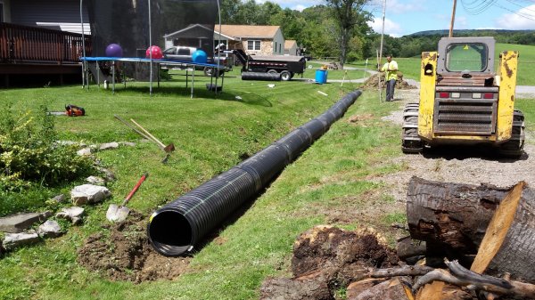

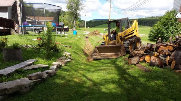

    A pic of it before we started....

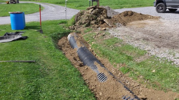

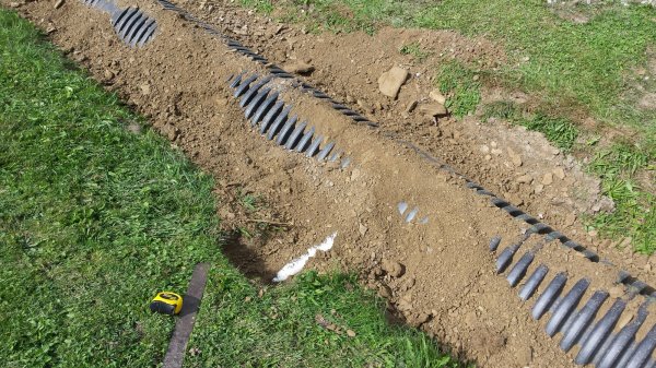

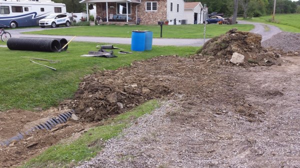

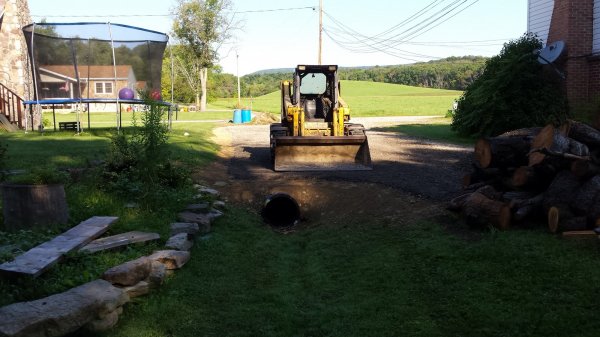

    Scraping out the belly....

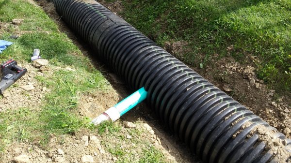

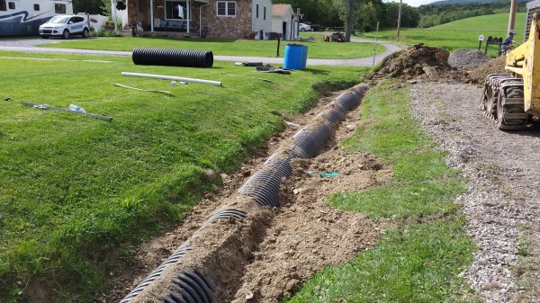

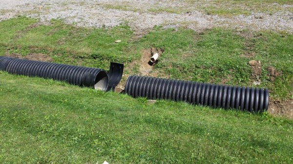

    Beginning laying the pipe. It's double wall 18" corrogated pipe, the road crew that my buddy works for gets these 10' sections for free because they are throwaways. Huge rolls of landscaping fabric they use come spooled on these 10' sections. I got 95' of pipe for free......I just had to buy the couplings!!!
    Stubbed in several downspout drain pipes as well as some ground drains from my place and my neighbors place.

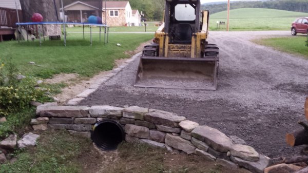

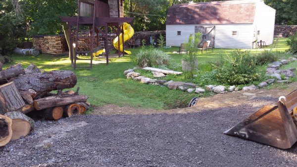

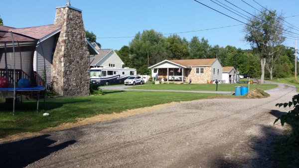

    Some more pics of the final grade and shale.....that messy flowerbed you see on the right of the first pic is going to get dug out later this week, that's where our new patio/pizza oven is going!!!

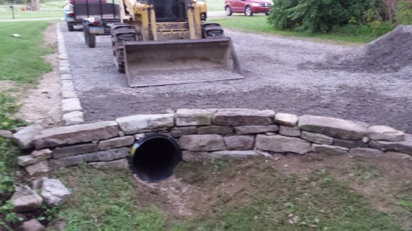

    Finished the project off yesterday with a curb made from almost 90' of recycled granite pavers from an old RR station from the 1800s that was torn down in our town over 60 years ago. And made a nice drystack wall out of boulders from the mountain by our house at the exit of the pipe. I'm very pleased how it all turned out!
