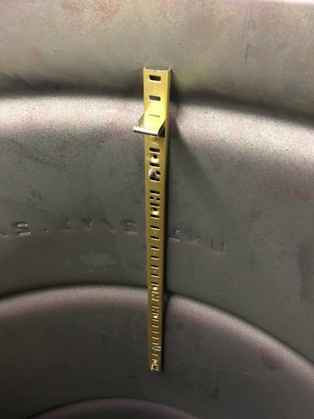

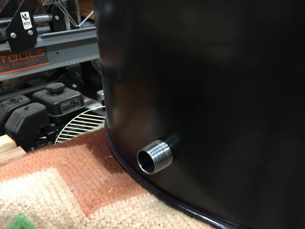

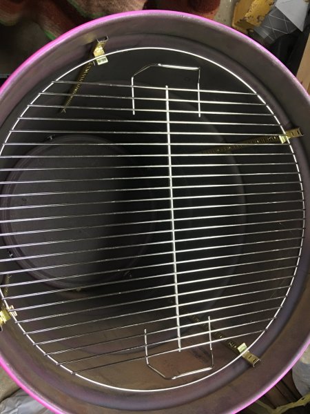

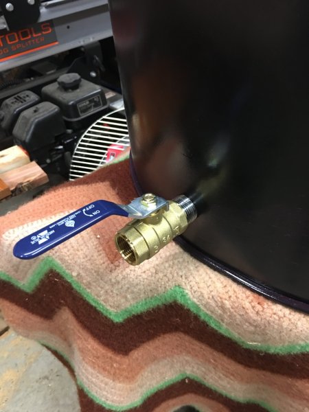

    Well, bought the drum in May, finally got a couple days to work on it in October. Better late than never I guess. Used to have a old charcoal box, rotted that out, now I have a masterbuilt electric that I love for convenience and the fact I can smoke in frigid temperatures but have wanted to get back to charcoal/wood for some time. Really want a nice offset smoker from Lang or one of the other fine manufacturers out there but this is going to have to do for the time being. Everything I've read on UDS smokers seems fantastic, people love em, they are cheap to make and I've heard they turn out some mighty fine Q. Will probably get to season it tomorrow and hopefully do my first cook in it this weekend. I still have some finishing touches to do but it's mostly complete. I don't have a welder and instead of asking to borrow a friends I just bolted the charcoal basket together. Anyone wanna enlighten me about exhaust port size? I've heard you want about double your intake size, anyone? I've got 4 3/4 inch intakes. Probably will never have to use all of them at once but figured why not. Three of them are capped and one has a ball valve on it for fine tuning. Open to any and all suggestions or comments. I know the color is quite bright but pigs are pink and I cook pigs in the smoker! Plus I have one finishing touch that should really set off the pink, just waiting for the man in brown. So here's some pics. Don't mind the pink on the inside, was spraying in 25 mph winds. Who else has a UDS?

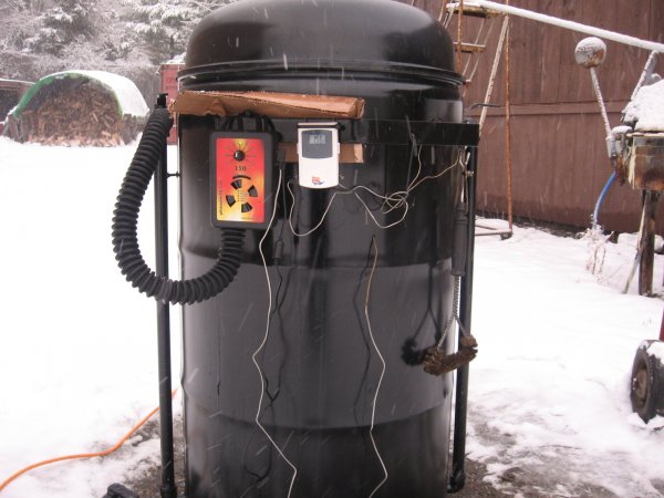

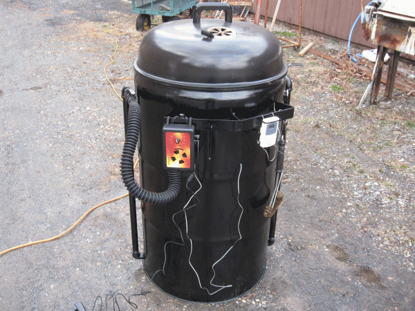

    looks good so far.....mine has three 3/4 intakes after its up to temp i IMG_1309.gif can run it on one(without the blower).as far as the exhaust 2-1/2 exhaust pipe will be plenty

    Awesome. That thing looks serious. I appreciate the advice. I'll start with the 2/1/2 in the barrel lid. If I get a Weber one the standard exhaust should be good, right? How did you make that one fit more air tight? I put mine on and it's a little small still.

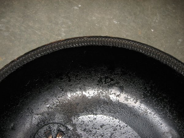

    yes standard weber exhaust is fine.....the drums im using are russian so they are 22-1/4"OD so a weber or other brand top fits perfect.....a domestic barrel is 22-7/8 or so
    heres a pic,i used flat wood stove gasket for the lid......its critical that everything is sealed!!!!!!!!! not for smoke,but for safety and efficiency!!!!!! DO NOT FORGET THIS!!! even the small like 3/16" holes for yer temp probes are enough to keep it smoldering for days.
    i dont see a heat deflector in your pics......you need one!!!!!or else.....
    also youll be fine with a flat top,just put your first grate down in the drum farther so you can do beer can chickens. IMG_0706.JPG

    I bought a second pizza tin to use as a deflector. That should work, right? Just place it on top of the coal basket? Drill a bunch of small holes in it?

    i wouldnt drill any holes in it,if grease drips in the fire it makes a nasty smoke that taints the food especially pork grease and burnt spices.
    my deflectors are cut from 11ga steel(i have a template,i build a bunch of these) it is about 3" above the basket.
    you want the grease to vaporize on the deflector or run off to the sides,not in the fire.

    Why do you run the intakes up vertically like that?
  14. fortydegnorth
    fortydegnorth
    Jan 31, 2016
    189
    929
    Kettering Ohio
    One intake is typically your control. The other two I usually leave open and I make adjustments with the ball valve. It's extended up for no other reason than I'm lazy and didn't want to bend over...
  15. cnice_37
    cnice_37
    3,205
    14,196
    Well.... that's a good reason!

    So I ran the UDS for about 5 hours today, it's actually still going. Just wanted to get a coat of seasoning on her and play around with the temperature control a bit before I put some meat on it. It's actually still running, gonna go check in a bit. I drilled 2 1/3/8" holes for the exhaust which is the biggest my step bit went.
    I filled the basket a little more than half with briquettes and chunked apple. Lit about 20 briquettes in my chimney and dumped it in the middle when they were ashed over, put the lid on. Had the ball valve wide open and one more 3/4" vent open. After 35 minutes I was at 244. Closed the ball valve about 1/4 and at 55 minutes I was still at 244. Left it there till 1:13 where my temp was at 248 at that point I capped the 3/4 valve and opened the ball valve fully. It was around that point the the wifey came out and wanted to see what I was working on out in the garage the last couple months. So, I took the lid off to show her how it worked and once I put it back together she spiked at 272. After that it seemed like I couldn't get it much lower than 250 unless I really shut down the intake which seemed to stifle the coals, and hit a low of 225. I usually cook most things around 230.
    I'm sure I just need to play with it more to get it dialed in. There was some condensation built up on the lid when I took it apart along with some in the bottom. Exhaust too small? Was about 45 out today with 15-25 mph winds.
