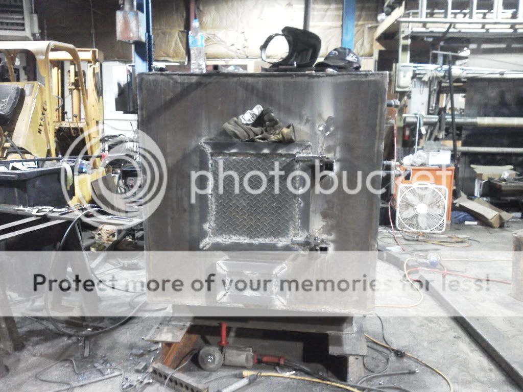

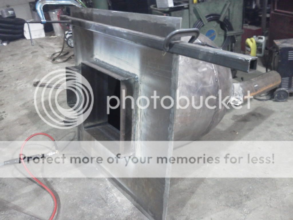

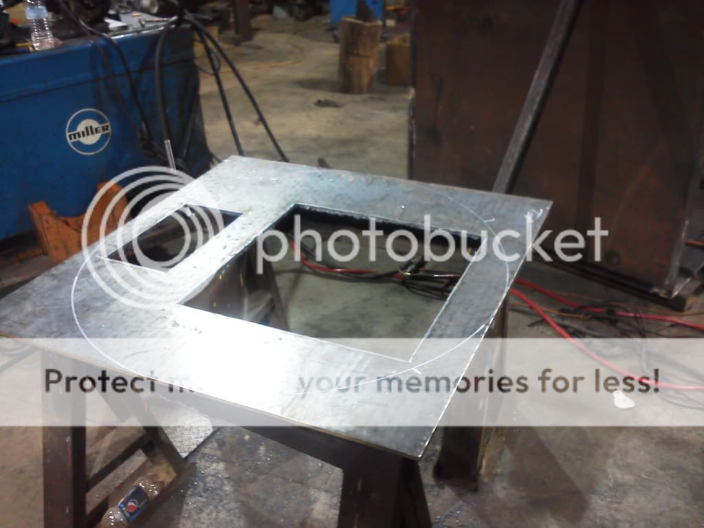

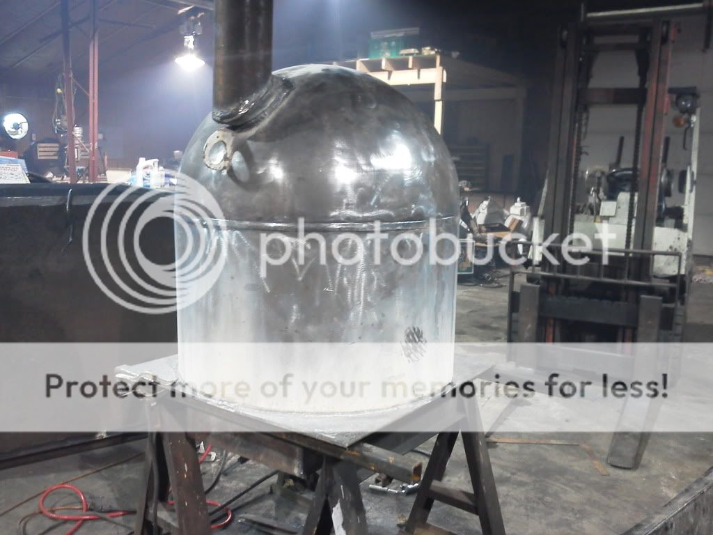

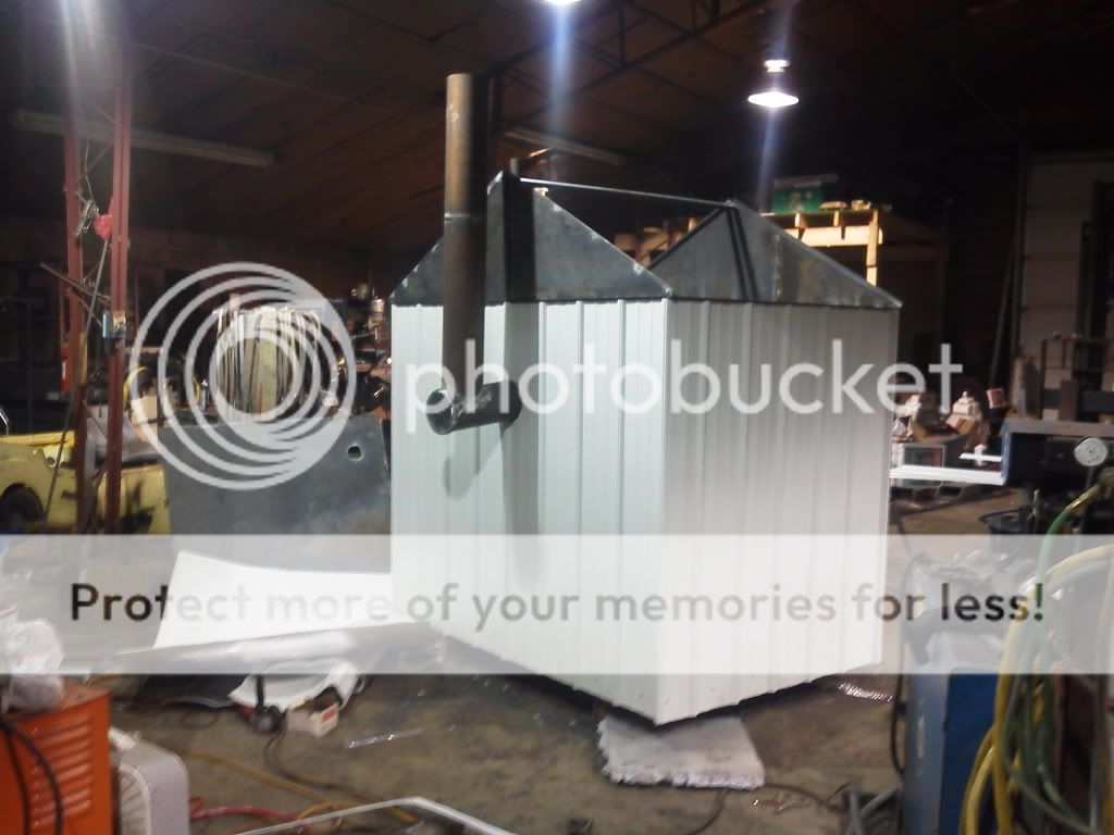

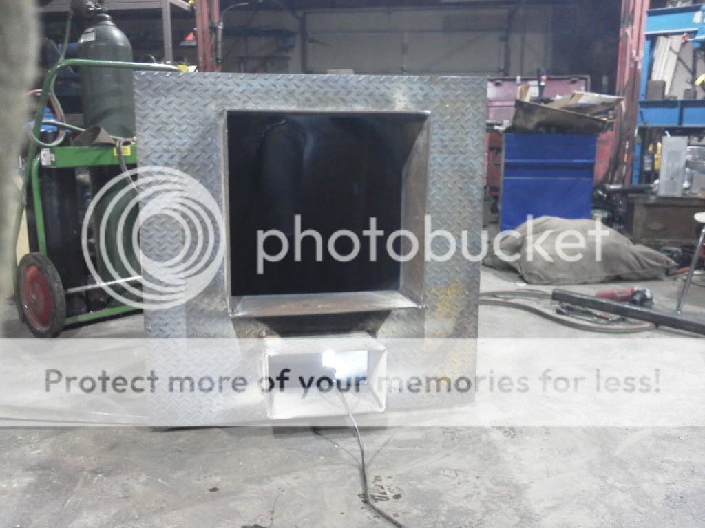

    Hello, fellas this was my first attempt at a owb.
    Well this is what got me into these chainsaw things. Now before you rip me a new one. I was only 22 when I built it. Nov 2013. [​IMG][​IMG] BOOM![​IMG] JK![​IMG][​IMG][​IMG][​IMG]
    Part 1 of many....

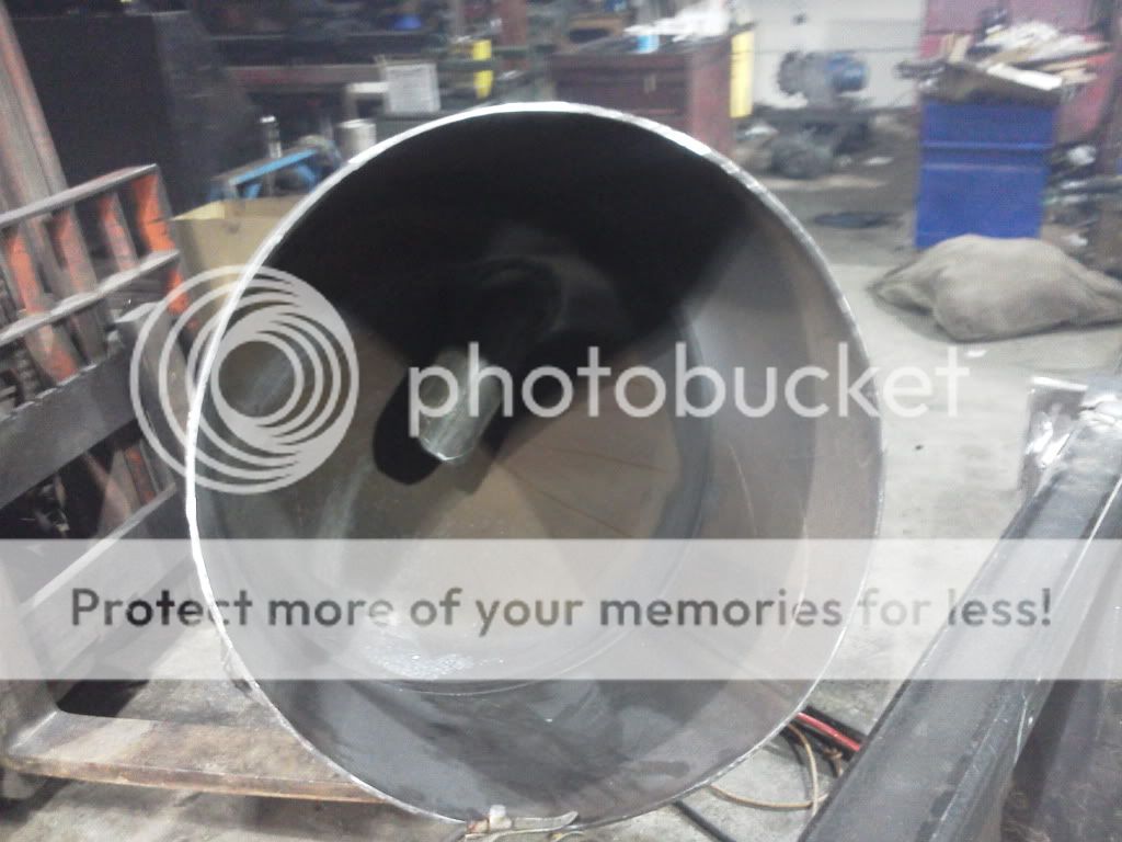

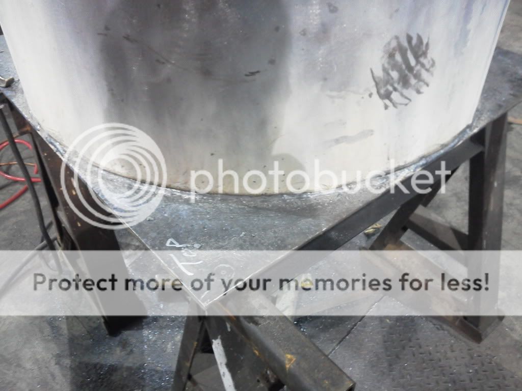

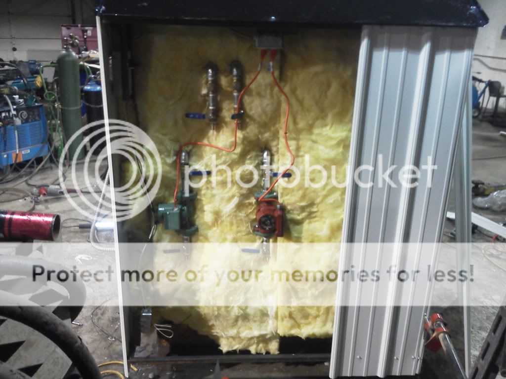

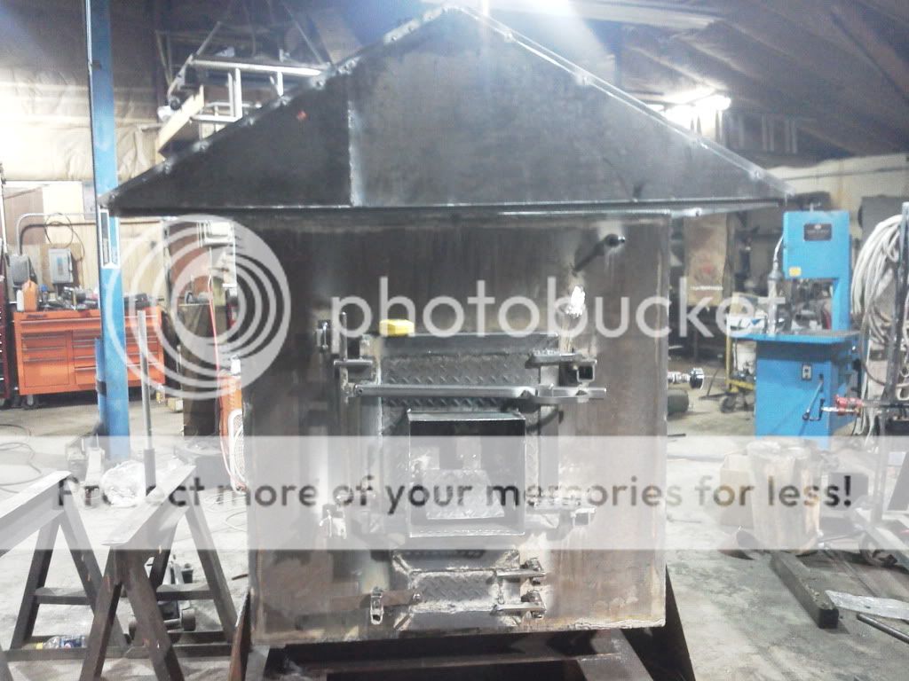

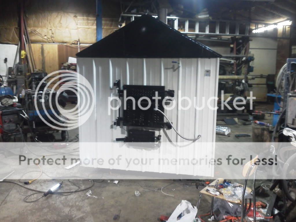

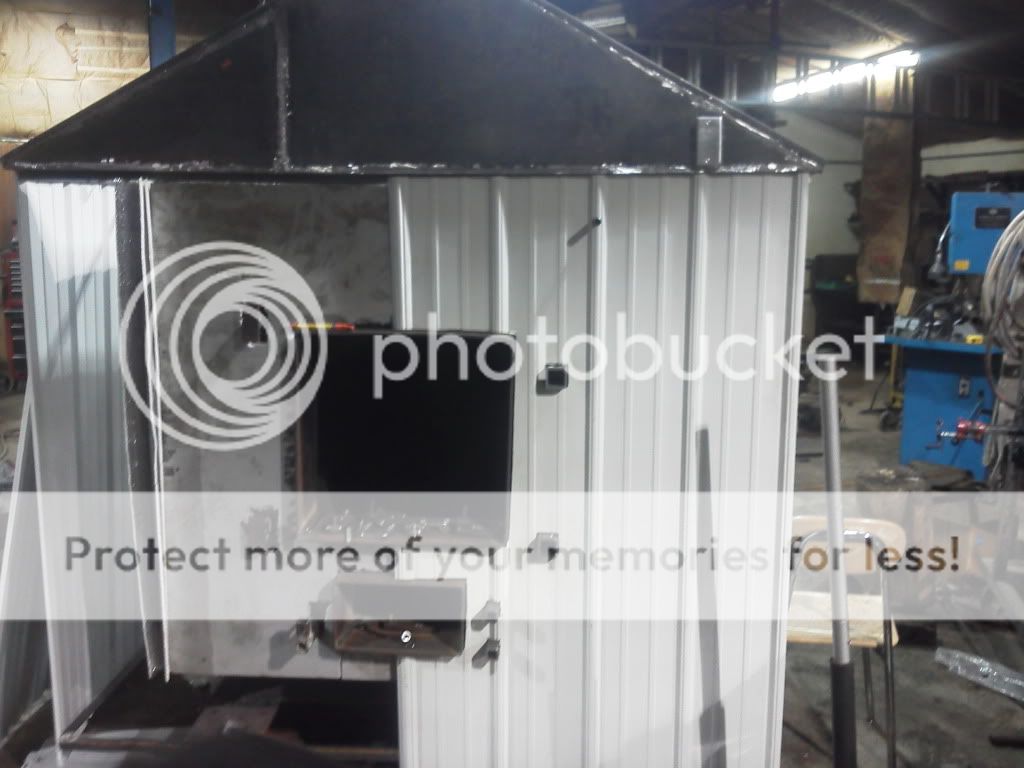

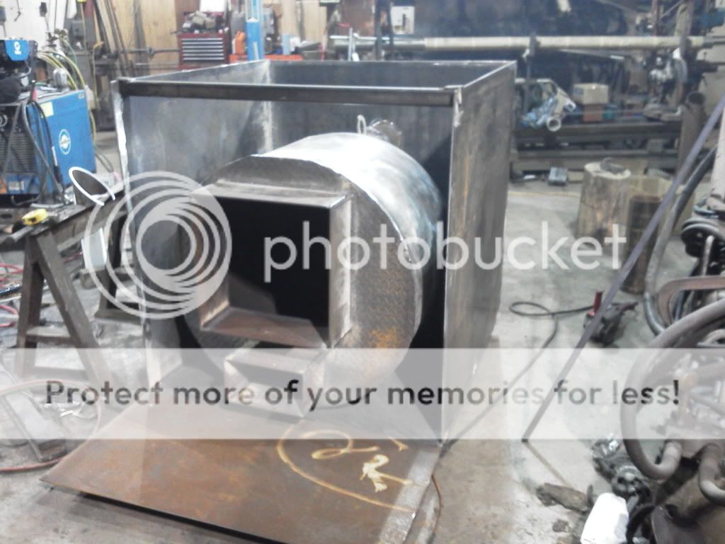

    [​IMG][​IMG][​IMG]Idle[​IMG]Full bore[​IMG] 4ftx4ftx1/4"water jacket 38" dia firebox 40" deep 3/8" holds just over 300gallons of water. Any questions?[/QUOTE]
    Just finished the 3rd season, before next season it is getting retrofitted with a forced air blower in the door. With 2 90's in the flue, and only 6" it can't pull enough heat to keep the creosote down in the flue.
    I know I know I need to work on seasoning my wood, but I only have 3/4 month to gather wood a year, and I travel for work. So I make the best I can with what I have.

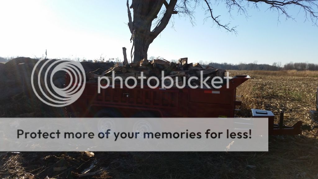

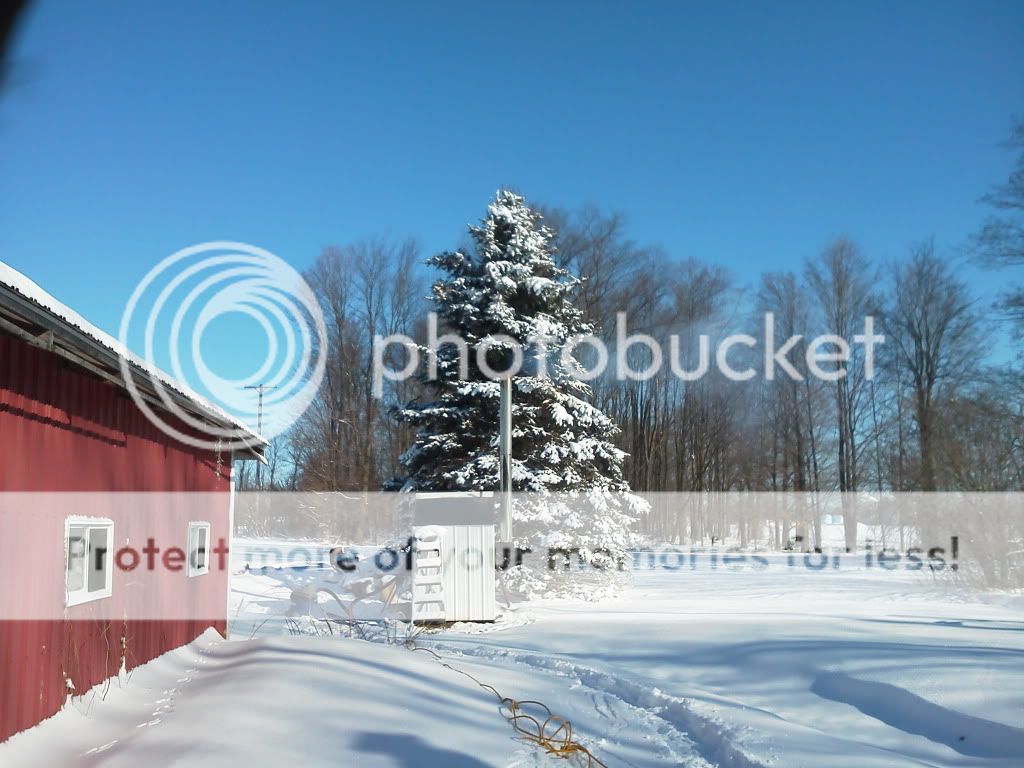

    Not heating the hot water, just the house and barn (kind of). Pumps through the barn 24/7 but only turn the fan on when I'm working.
    Best I can figure 8 ish full cord.
    Little load of ash
    Little bit better load of oak.
    Used 4 trailers + some I had leftover in the shed. Less than a face cord. Burned from nov-april

    is you firebox lined with brick? do you have damper controlling air intake now? what temp loss do you see in underground piping? do you run circ full time to heat exchanger in house? with the stack reaching that far into the firebox do you get any flashback when you open the door?
    consider a cleanout on your outside 90 next time. be careful with larger water capacity. wicks a lot of heat away from the fire and prevents it from burning efficiently.

    Thank you,
    The fire box is not lined.
    I have a solinoid to open the damper, controlled by a ranco aquastat 170 on 185 off
    Only have a 60ft run, with my homemade lines maybe 2-3 degree and a 20* drop out of the exchanger.
    Circ pups run 24/7 365 haven'tunplugged them for 3 years now.
    Only time I get a flash is if opened on a burn cycle.
    I have a cleanout on the stack, just being uninsulated it clogs up bad.

    might wanna try lining the bottom half with firebrick. that allows the fire to get hotter and burn more woodgas. as is, the sides of your burn chamber dont get much hotter than 200*. it wont burn more wood, but you will get more heat AND higher stack temps to help combat creosote in stack. downside is slightly less usable volume in firebox. additionally, the bricks continue to give off heat if you are not around to reload.
    2-3* adds up to be quite a bit of BTUs if circ are running 24/7.
    that being said, you are doing really good heating with only 8 cords/year! is that 3yr avergae or just for last year?

    I'm curious why you turned the stack down inside the f/b?
    Red97 likes this.
  20. Red97
    Red97
    May 2, 2016
    307
    1,231
    Mi
    Idea was to keep the heat inside the fire box. Works a little too well, hence the creosote issue.
