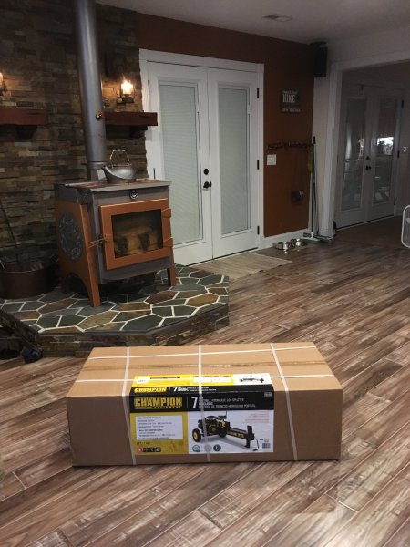

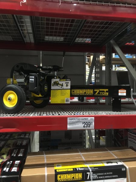

    Was with the wife at Sam's Club tonight, and decided to go look at the splitter I've had my eye on there for awhile. Anyone here who does the Sam's club thing knows they tend to mark their seasonable items down, and this was no exception. It was $450 a couple of weeks ago, but tonight they had marked to $299! So home with me it went. With my $70 in birthday money I received last week, this really only cost me around $230 before tax. It seems to have good user reviews online, but does anyone have this one? I'll post more pics as I put it together this weekend.

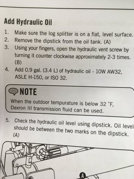

    I'll go out tonight or tomorrow for hydraulic oil. Is there any particular one listed here in the manual that is more recommended? It's giving me 4 choices. Not planning on running it below 32.

    Dexron would be easy to get in a pinch. Even the local drug store has it on their shelf. They do not have any hydraulic oil though. I see lots of equipment running it even if they don't get used below 32. Keep us up to date with the assembly and maiden voyage.

    The AW32 is super easy to find at places like NAPA, TSC, Farm/Fleet type stores.
    My 23 ton Champion holds a lot more oil than that, but I bought a 5 gallon bucket of AW32 for it...$25 IIRC

    I have the 22T Champion and it's served us well over the past four years. I run AW32, and when I've split below 32°F's,
    I usually pop the recoil housing and spin the crank with a 1/2" drill and a 3/4" socket.
    Works like a charm, but glad I don't really split in the chillier temps (in F's) much anymore.

    You can also to TSC, fleet and Farm or Farm and Fleet ag supply stores. There hydraulic oil is about as reasonable as you'll find. The normally run sales as well. They were mentioned before but check your prices as it does vary. Ag Tractor dealers are better to some but the prices will go way up. For a normal homeowner, it is not really needed in my opinion.

    Dextron may be easy to get but at $5 per qt you might as well get a 5 gallon bucket of aw32

    For a gallon system, I'd run Mobil 1 5W30 synthetic. Covers all temps & takes heat better than about anything else. Been used in hydro systems on commercial lawn mowers for years. Small capacity, no coolers, & high heat.

    Thanks for weighing in! I'll shop around, but it sounds like from what I'm hearing, there aren't any "wrong" choices from the manufacturer Recommendations.

    ...now...how to get it out of the living room :doh: ;) :rofl: :lol:

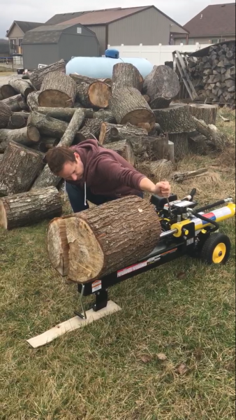

    We have lift off! (Or split off?) I got in a whole 2 rounds before the rain hit. It's 68 degrees here right now (avg temp is 46), so it really is splitting weather (well, until the clouds split)
    I ended up going with the aw32 oil. It seemed as good as any. This went though that good-sized round like butta. If that's a sign of the future, I think it's a good purchase. I'll do some more reviewing as I spend more time with it.
