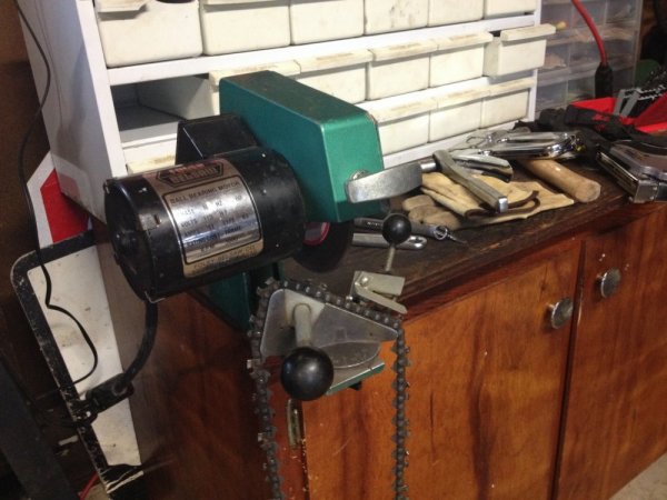

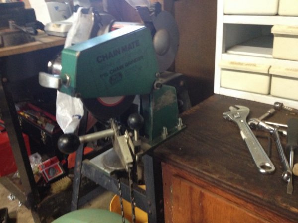

    Thanks to Gary ( GuidoSalvage).....i am the proud owner of this gem :). Got 2 new different size wheels that shall keep me busy for a while ! Custom front handle... Tightened all screws... And some junk practice chains ...and im up and running. I have no manual.. So ive been trying to figure it out on my own. Think im doing a fair job. Open to any suggestions . Thanx again Gary ! image.jpg image.jpg

    Sounds like just in time too.... Looks good on the bench..:thumbs:

    30° on the cutter and 60° on the head angle (if adjustable), are pretty standard angles.
    Go to 25° if you want a longer lasting cutter (not as sharp) or 35° if you want a faster cutting cutter (won't last as long). 30° is right in the middle. But experiment and decide what you like.

    I don't know grinders but that looks like it would last 3 lifetimes.:dex:
    Correct radius on the wheel will be the critical for proper hook.

    Awesome Fuzz! Be careful of the wheels exploding brother it does happen although not often and that has no real guard on the lower half. When they go boom it's like a mini shrapnel bomb going off...
