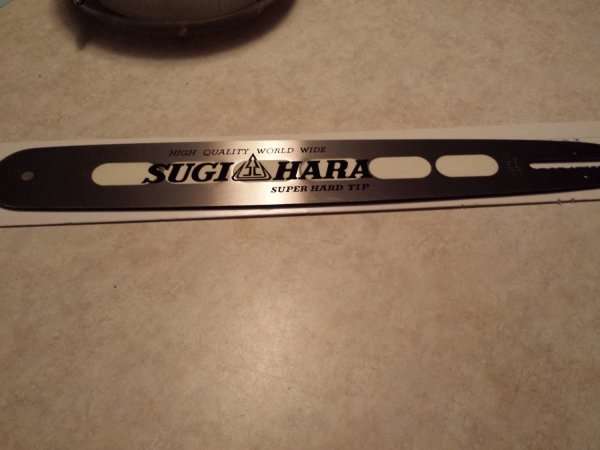

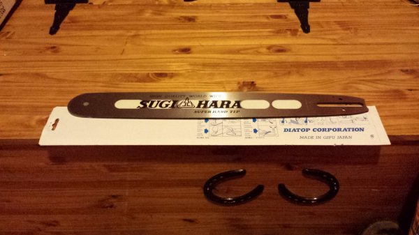

    It finally arrived today. And had plans of installing on my 044. But thanks to Devin86, I have another MS 460 that will be here tomorrow. It will be going on it.
    Already ordered some nice parts for the MS 460. Caber rings are 1st on the list. For $14 they are well worth it. Delete base gasket and you gain a fair amount of compression over stock.
    Will wait till I see it before I order anymore plastic, wrap, etc.. But I am excited!!
    The Sugi is only a Hard nose, but it should suffice. :)

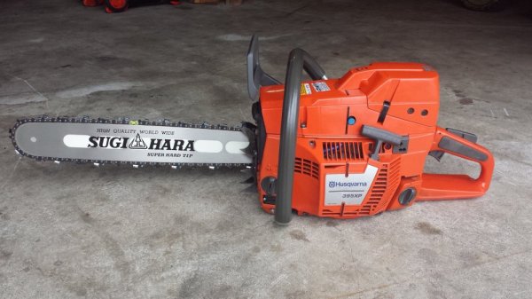

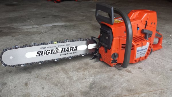

    Well, I mounted it today. I took the 16" off the 395XP and put the Sugi on...
    Looks a little better, but I still need a 24" or 28" to make this thing look like it means business.

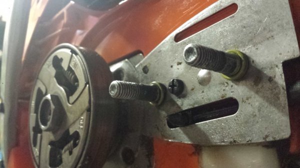

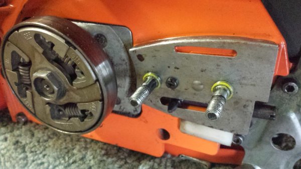

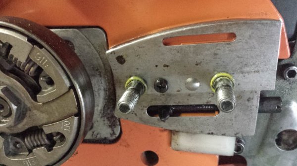

    Oops. Forgot pics of the spacers..
    This bar will fit over 100 saws. Just have to use the appropriate spacer (comes with several sets). For Husq you use the Yellow Spacers.

    never heard of, what are the advantages to this bar?

    Light weight bar that has no paint. The white pieces are inserts to reduce weight.
    Lots of Manufacturers try to hide imperfecrions, rivets, etc. This shows the true beauty.
    Plus the name sounds Cool :)
