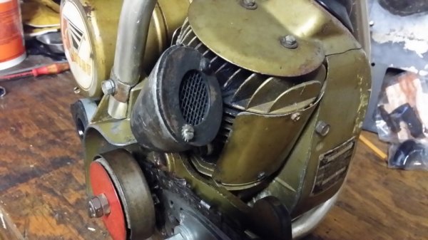

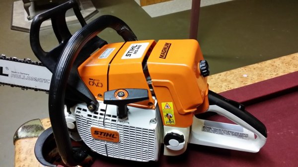

  19. DexterDay
    DexterDay Administrator
    12,411
    31,628
    Northeast Oh
    Just got this purty one in today ;)
    I'm sure we'd get along just fine :thumbs:
    As for Old saws.. This old Clinton has a wide open hole on the end of the Horn(or muffler).
    I'm sure it's plenty loud enough :dex:
    clemsonfor, thistle and $ooline like this.
  20. bigbarf48
    bigbarf48
    Sep 25, 2014
    2,344
    4,701
    Stone Mountain, GA
    That's a purrrdy lookin 440 there dex :drool:
