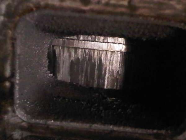

    Pull the muffler and if the piston looks anything like this:
    Your piston is shot.
