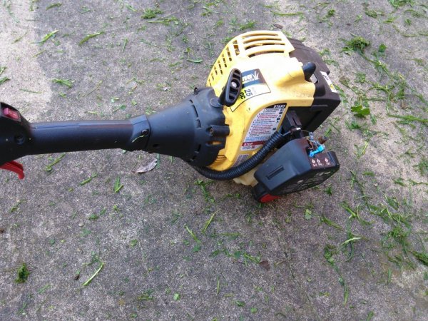

    So I finally got around to it!!
    I got this almost new weed eater a bit over a year ago. It was a gutless 25cc Bolens by MTD big box special. One of those curved shared jobs that you get for like $90.
    It was pretty weak. Good for a city lot owner that weed eats every 1-2 weeks. But for us in the country that only get to it like 3-6 weeks or so or have ditched etc its under powered.
    I would take it to the farm 3-4x a summer as it was light and cheap and I dont have to drag my echo there. But if I was going to do the ditch I would use the echo but usually took this one as it was light.
    I got the idea to muffler modd it but it had D shape screws. So iI ordered a special screwdriver bit never got to it this summer.
    So I took the time to do it.

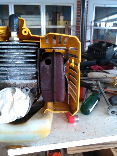

    I did not realize the plastic cover was also the back of the crank case!!!!

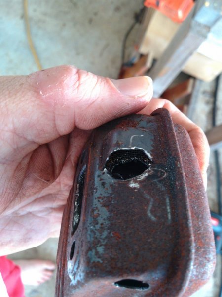

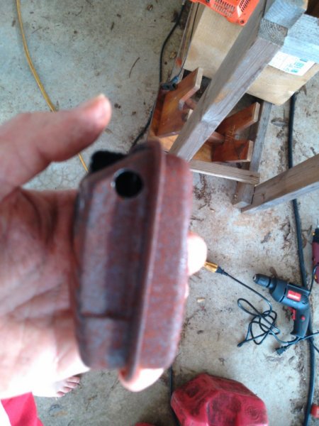

    So made some slots in the cover to remove the screws. I widened the port and ground out the screen and drilled out the baffle on the top and added a second 3/8 port on the back side.
    WOW is all I can say. Cuts like my larger straight shift echo thats 32cc I think and feels like it has more torque . Its just a bit louder as well. But this thing has some @$$ behind it now. Can pull the .095 line through tall shin deep vegetation like nothing now!! Before it would bogg out.
    Took about half a turn richer or more on H and just a hair on the L and then required the idle to be turned down. IMG_20140323_164917_082.jpg IMG_20140323_164906_493.jpg IMG_20140323_162247_195.jpg IMG_20140323_162236_770.jpg IMG_20140323_163411_715.jpg
