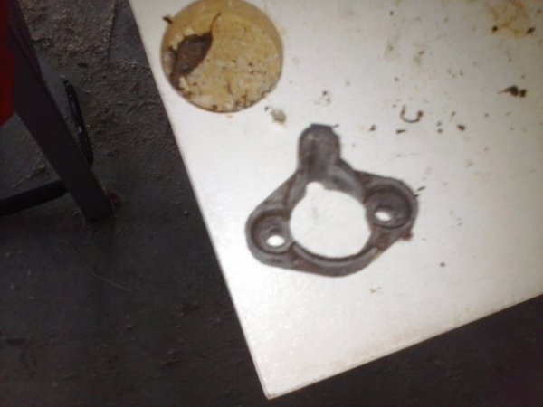

    i dont recognize this oart from last time i tore a stihl down. that does not mean its not there though. what is it and does it belong on a ms650? go behind carb ? dont think so. pretty sure the 390 dont have it. im thinking its just a part that was thrown in thebox at the shop ? ill post a oic next iys not letting me fir some reason. the puc add feature is a bit glichy it seems ?

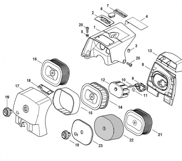

  8. MasterMech
    9,648
    26,019
    Greenville County SC
    If it does indeed belong to the 650, it would be near the top of the intake stack, under the filter. Looks like #9 to me. ;)

  9. clemsonfor
    clemsonfor
    15,996
    37,473
    Greenwood county SC
    yep thats it. thanks. where dis u get the diagrmm ?
  10. MasterMech
    9,648
    26,019
    I have the IPL for the 660, which is pretty much identical to your 650 except for the top end AFAIK.

    and what is part 12? is that part of the air filter?
  14. MasterMech
    9,648
    26,019
    Part 12 is the baffle under the filter. I will get you your part #'s tomorrow.

    alright MM i think i found another part i need. its an inner filter its part #8 in the diagram. i found it while browsing ebay. when i get a chance get me that paet number andthe number for 9 &10.
