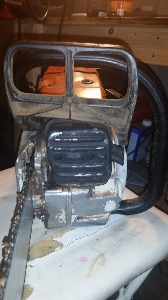

    downloadfile.jpeg Hers the victim.

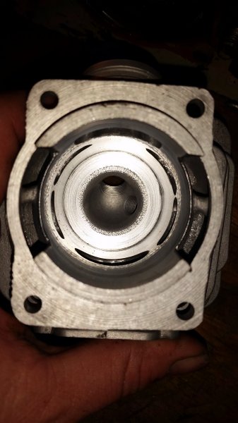

    20150107_164345.jpg I cut .035 " off the squish band and then cut the base so my squish ends up at .025" I don't like really tight squishs. This yields a compression of just a little over 200 lbs. Makes for a nice torquey saw when combined with the port work.

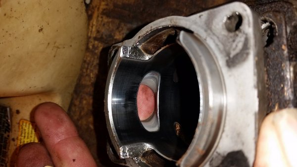

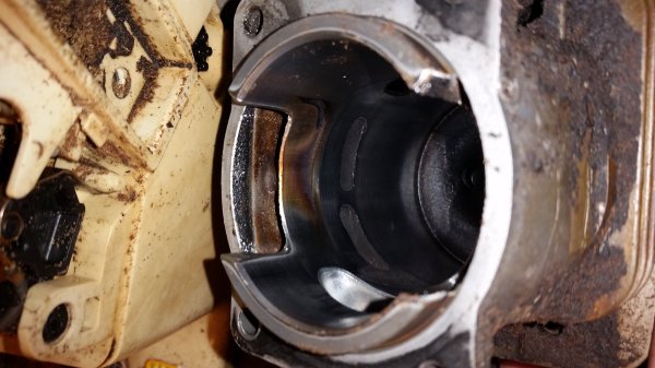

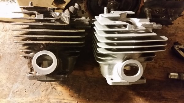

    20150107_164339.jpg 20150107_164332.jpg 20150107_164207.jpg With the squish band cut my intake winds up around the 78-79° mark. I then us the piston to push the ring up in the cylinder so I can mark the bottom and roof off the intake. I use a red permanent marker to draw the lines. I then use use a a 10mm flat metal ruler to mark the sides. A business card will also work. So u end up with a square mark around the intake. I do not widen the intake on this model. Just square it up and and blend all the way out. These pics show a stock and a ported cylinder. The dirty one is stock.

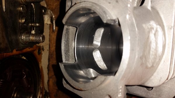

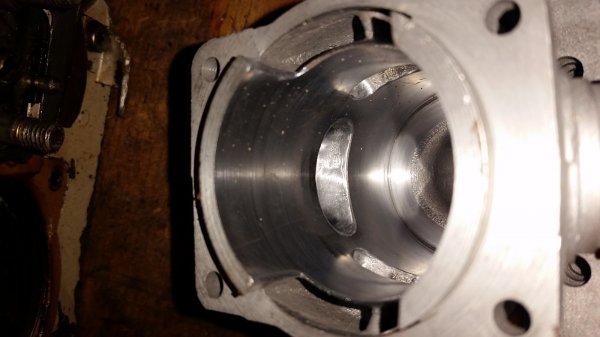

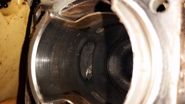

    20150107_164317.jpg 20150107_164324.jpg I set all my heights by pushing a ring up and marking it with a permant marker. On the trans I push the ring up and set them at 118-120° the only time I've seen this 2° make a big difference is if your porting a big bore kit. And that's to do with case volume, velocity, etc. On these I also widen the rear trans just a little back towards the intake.

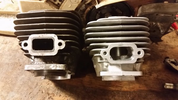

    20150107_164309.jpg 20150107_164303.jpg 20150107_164226.jpg Now the exhaust. I widen it out to about 65% on this saw. Heeding in mind the skirts and ring location ends. I flatten the roof a little and blend out. On the outlet it's made much bigger. Just lay the gasket on the cylinder and mark it out. To match I generally go just a bit more but gasket matching works really nice. The dark spots on the oem cylinder pic will all be ground out.

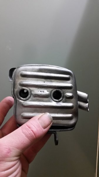

    20150112_160427.jpg 20150108_111037.jpg I advance the timing a quarter of a key and then I Muffler Mod it. I decriminalization the muffler and remove all the baffles. I port match the muffler inlet to the cylinder out let. I then add a second port on the opposite side of the main exhaust port and open up the main. Now I didn't like the outcome of this one but it gives u an idea. It's at 95% of cylinder exhaust outlet.

    ia
    Will it run like that?

    It runs very nicely like that. IMO. Lol
