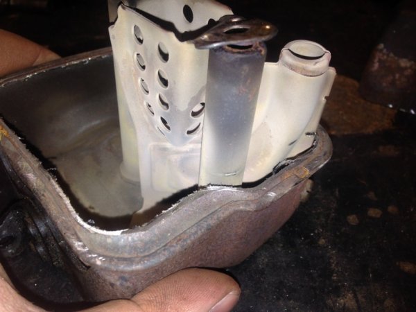

    So I have a couple of these kicking around the shop now and one has a nice big dent in the side of it. I decided it would be the perfect victim to sacrifice in the name of science. Opening this thing up has given me a ton of insight as to what's inside these and why the 361's Achilles Heel is it's muffler.
    Back Cover -- The outlet on these actually points backwards towards the operator, relying on the deflector to turn the exhaust around towards the front of the saw.
    And here's the front half. Big birdcage type baffle that empties into the can. Exhaust in the can then has to find it's way out through that pipe. Extremely restrictive.
    Also note that the pipe and baffle assembly is spot welded pretty securely to the front half of the can. So don't get any bright ideas about twisting it up and yanking it out of there without splitting the muffler.
    I now have a pretty good idea now of what I want to do muffler-wise for my upcoming 361 project. :sherlock: :dremel: :saw:

    Yep......dem is a crappy design.

    At least this thing looks like an engineer thought it up. The 1127 (290/310/390) series mufflers are just "special". Two outlets the size of a tic-tac for a 65cc saw. :picard:

    Wow... The two MS 361 ' s that passed through my hands were not impressive in my opinion.. Because of the need to split the muffler, they were the only 2 saws I probably never messed with.
    This thread shows exactly why..
    If all that garbage was removed, or another port in the side of the muffler was added? They would have ran MUCH better.
    MasterMech, Are you gonna post up pics of the muff mod you intend on fabricating?

    So it looks like another port could be added just about anywhere, avoiding the need to split the muffler... Or is the cage too restrictive? Maybe just drill out part of the cage through the inlet?
    I agree with Dex... I had two different ms361's and I thought they were complete turds. I wish I would've tried a muffler mod on one of those saws before I got rid of them.

    Yup, a port anywhere on the can will improve flow. The bird cage ain't all that bad, lots of surface area and lots of holes in it. Plus it will do a lot to keep noise to a reasonable level.

    I've seen dozens of those saws with a bunch of hours on them that the cage had come loose and was rattling around in the muffler. I've even seen em run so long like that, that the cage was beating holes in the front of the muffler.

    :rofl: :lol: This one is spot welded in there pretty secure. But I'm pretty sure this was a very low hour saw that met an untimely demise under a truck tire.
    If the cage would pull loose pretty easy I could get it outta there without too much drama.
