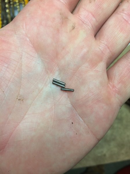

    Ok so I dig into the clutch housing and all these little pins fell out. What did I break? Lol
