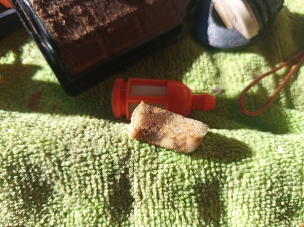

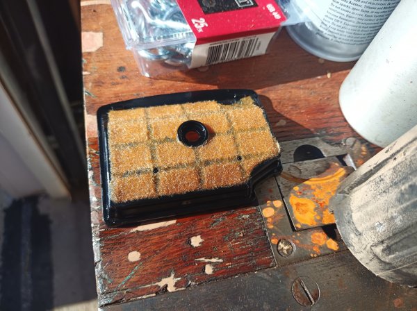

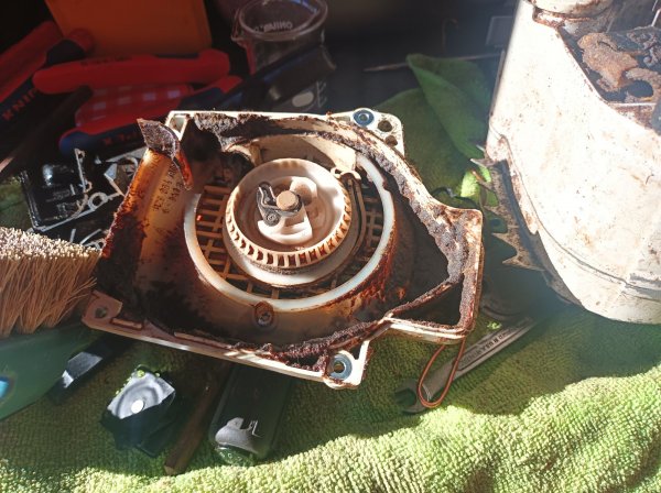

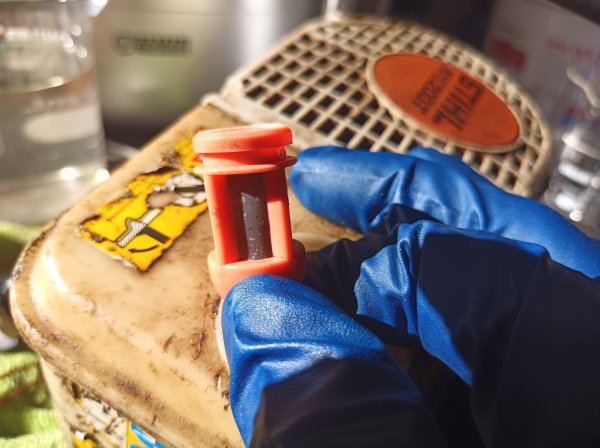

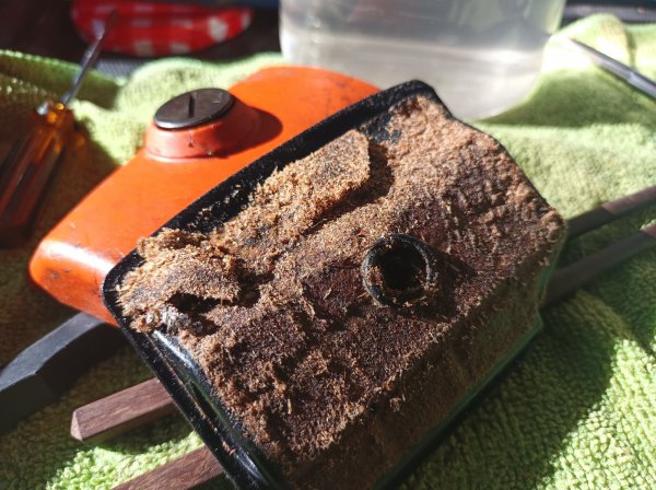

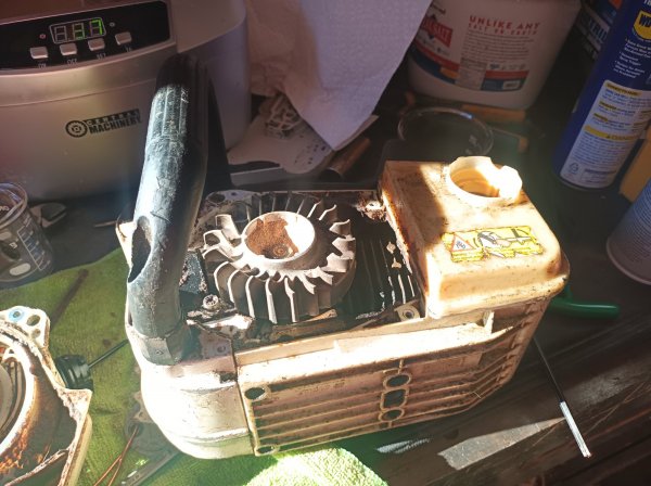

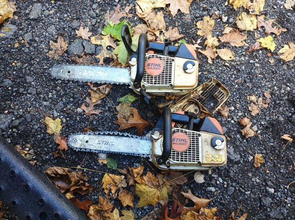

    First one that has good compression had a filthy air filter. Also the fuel filter cap fell off, weight was off, and the foam insert clogged with sawdust. Going to clean it up and see if she runs.
    I sprayed the air filter with brake cleaner and it did a great job of cleaning it up.

    Air compressors must not exit in the place those saws came from.

    Air compressor and a minute of your time when done cutting makes all the difference in the world.

    Not saying those saws ever got cleaned, but 200,201’s wad up the filters worse than any saw I’ve used. One use and they are packed. I looked at buying a 200t a few weeks ago. Couldn’t find one out of 4 that didn’t have issues.

  7. LordOfTheFlies
    LordOfTheFlies
    Apr 5, 2019
    2,519
    12,097
    NY
    Not at this time. In fact, there's another set of ms200t twins that needs to be looked at. I'll ask but I don't think so either.
    Very excited to do a piston/cylinder on a top handle saw as I have not done one previously.

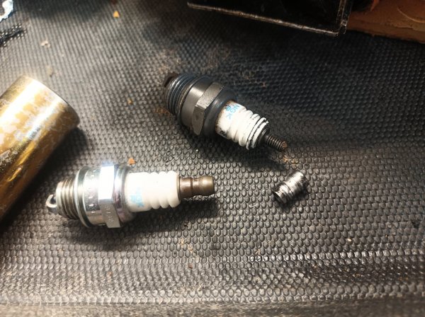

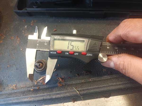

    Took a look at the second one and yeah it needs a piston and cylinder. The soark plug hole is stripped. The old plug came out weird and would go back in...weird....and when I tried to put a new plug in, no dice. The plug wasn't even in the hole which is why it had no compression. The tip of the plug was also broken and stuck inside the plug wire.

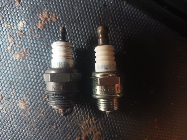

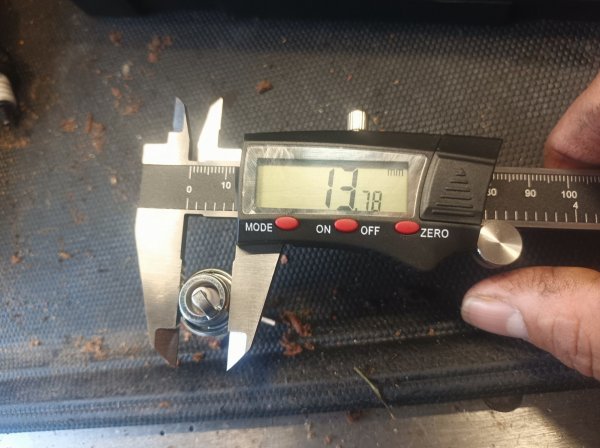

    So another weird thing these plugs are supposed to be 14mm and the new one is.....but the old one measure over 15mm. I think this saw got super over heated and the plug popped out of it. The hole for the plug is too big for the new spark plug!! It will not catch any threads at all and both are NGK BPMR7A plugs! So I whipped out the caliper and lo and behold this is what I saw (no pun intended):
    BuckthornBonnie MasterMech M2theB have you guys seen this before???

    Well that is interesting. Never seen a plug with that thread but when I get a minute I am going to do a little homework.
    I have seen 14mm , 18,mm some massive thread they used in tractors from the 40's but never that.
    Do you think at one time the original 14mm got stripped so someone found that plug with a larger thread and rethreaded it to make it work?

    Looks like an insert or helicoil stuck to the old plug.
