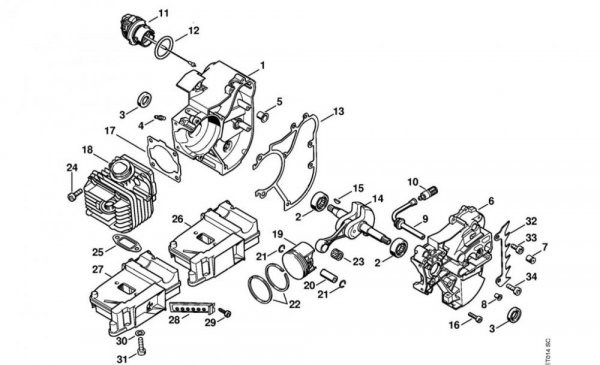

    Using it to to seal a muffler is a first for me tho. Usually a gasket in there from the factory. The MS200 muffler looks to be one piece by the IPL? I haven't played with one in 10 years or so. A bit rusty with that model I'm afraid....
    #27 is the US muffler.

    Nope, it's two castings screwed together. I guess it's only sold as a unit, though. The sealant must be there to prevent the plastic parts around the muffler (like the gas tank!) from getting hit with hot exhaust leakage. The proximity of the gas tank would explain why they'd only sell it as a sealed unit.

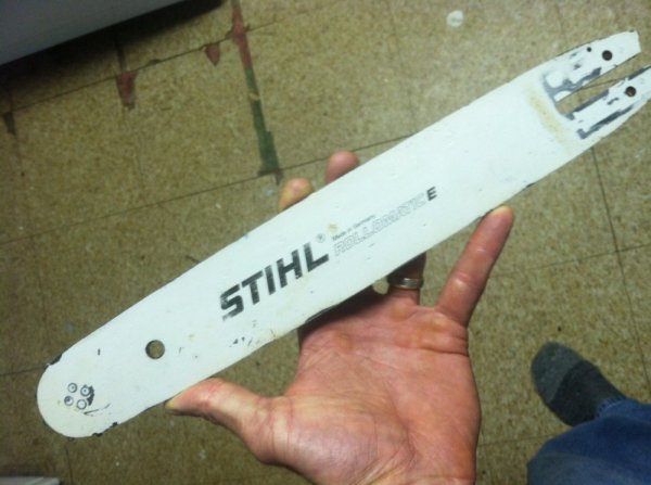

    Because mild cruelty is fun, this is the original bar.
  13. MasterMech
    9,648
    26,019
    Greenville County SC
    Pfft!!
    Hear I was expecting it to have an E-Light on it or something else good......... :p :p :p
    clemsonfor and Jon1270 like this.

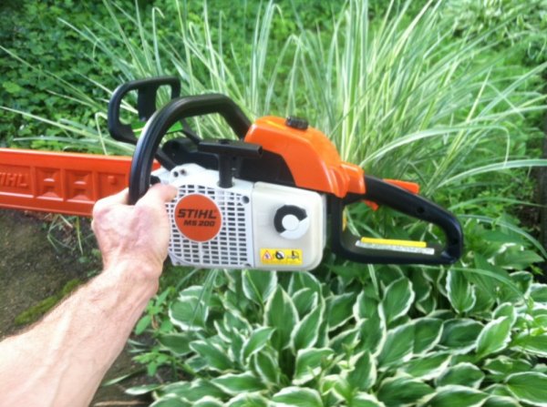

    Here's the rest of it.
  15. MasterMech
    9,648
    26,019
  16. Jon1270
    Jon1270
    1,886
    4,543
    Pittsburgh, PA
    I aim to please.

  18. Jon1270
    Jon1270
    1,886
    4,543
    Pittsburgh, PA
    Yeah, I don't what to make if it. It's like an alien creature amongst all my other saws that have, y'know, actually been used.
