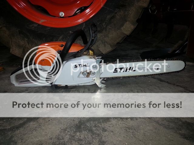

    After waiting forever( 2 days shy of a month) I finally got them today.
    [​IMG][/URL][/IMG]
    [​IMG][/URL][/IMG]

    Looks great. Can't believe I missed this thread.

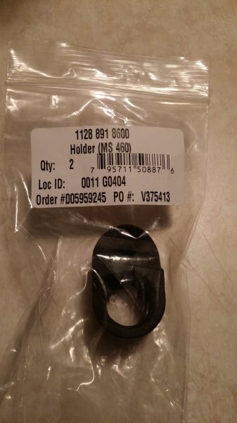

    The Stihl dealer. They are cheap (less than $5 cheap).
    I just got 2 more today. Part #
    1128 891 8600

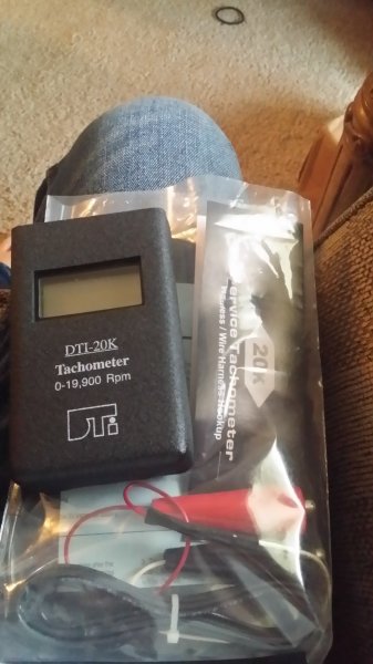

    Looking good!! Love a tach on the saw.
    I finally got my new Tach last week!
    I love it!!

    Do you have a tach on each saw to satisfy curiosity?

    Depends on whos curiosity needs satisfying ............:loco: :crazy:
    I suppose for some, they serve the exact same purpose as your CF graphics do :rofl: :lol:
    For others they provide an exact amount of run time :yes:
    And for those that might feel left out, they help to tune in the cut :thumbs:
