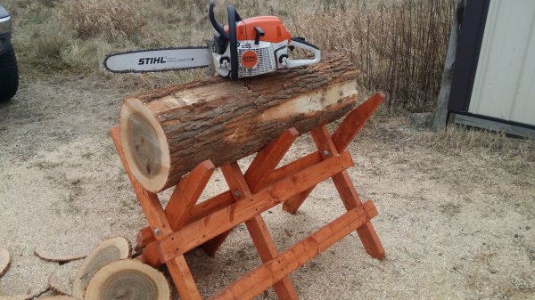

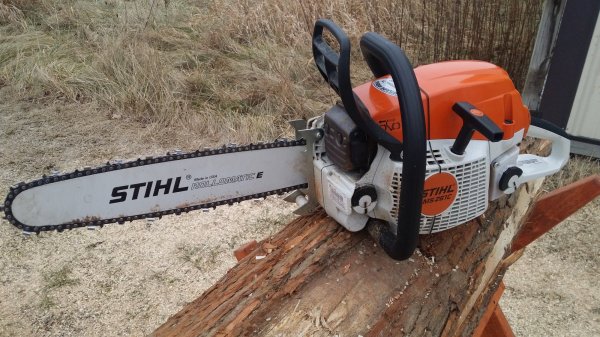

    Some pics of the saw.. :D
    Also, I got a new addition to my cutting arsenal. A member (unnamed, unless they want to come forward) sent me a Sawbuck (all hardware and glue included) as a Christmas present. This wasn't my Secret Santa, just a regular member. Forever thankful.. It needed stained and assembled, but this gift is my favorite already this year! ! :dex: Thank you!! You know who you are!!
