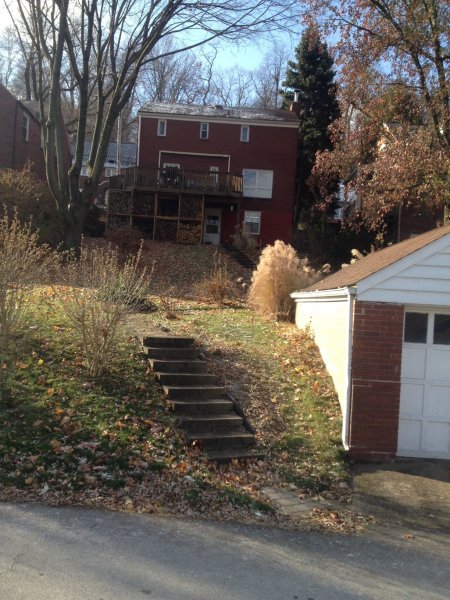

    I'm a excellent rigger in more ways than one. Can we get a pic of the hills?
    wildwest likes this.
  12. Jon1270
    Jon1270
    1,886
    4,543
    Pittsburgh, PA
    Sure, hang on...

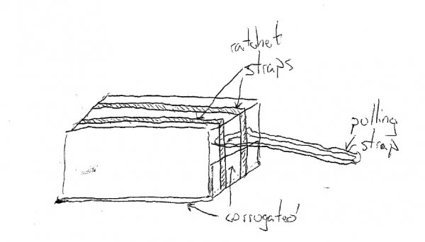

    How heavy is this? For something 150-200 lbs and under, I'd probably tip it on it's side with a sheet or 2 of corrugated long enough to cover the side as well as a few inches of the top. Use two 1" ratchet straps going the length of the corrugated to hold the box in place as well as the folded over part. This has basically made a sled out of the corrugated with the straps keeping things from sliding around, as well as creating an attachment point to thread a third strap to for pulling. Corrugated slides amazingly well on grass, so buy a cheap come-a-long and winch that thing up the hill with the come along attached to a tree (if you have one other person you may be able to just pull it without a come along). If there isn't a tree around, pound a t-post into the ground and winch from the bottom of the t-post. Once it's on flat ground you may be able to drag it yourself or with a buddy. If you can't, make 2 runners out of 2x4's on the ground, and buy about 5 one or two inch dowel rods to roll it Egyption style on. I moved a 800lb gun safe recently on dowel rods and 2x4 runners, I was able to roll it myself on the dowel rods.

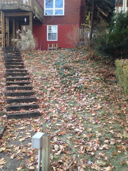

    I didn't know there were stairs!! If there's stairs along the entire incline, rent a stair climbing dolly. They work amazingly well, I helped a buddy move a 500 lb safe into a basement with one recently.

    They aren't great stairs. They were built from patio / retaining wall block which tend to slip out of place under duress.

    If the ground was dry ,,,and I was yur neighbor , my little Toro Dingo would scoot right up that hill with a few hundred pounds on the forks.
    You could "hillbilly" it too. Long rope through the crotch of that tree,,,,, car hood,,,,,,rope to bumper of truck,,,,,,, wait till it snows a little or just giverell on the grass!
