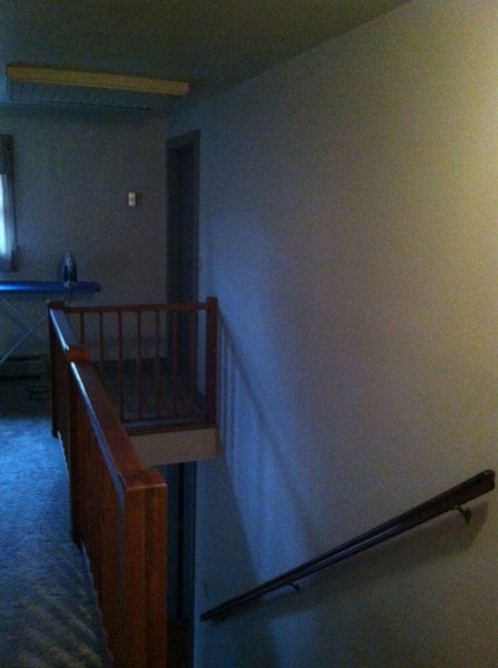

    To move air upstairs I have been using a box fan from the top of the stairs in pic 3 blowing the cold air down which brings the temp diff from 8 to 4 (wife hates when I do this). Would I be better off using the whole house fan in pic 4 and 5 for a couple min to get the hot air moving up then shut it down or would heat loss be too great? Otherwise Im going to throw insulation over the top of it and close it down for the winter. Thanks guys!

    I would cover that whole house fan. Heat loss there can be huge.
    Can you put a ceiling fan in the top of the stairwell? Put on winter mode, it will pull up the warm air and mix it with all the surround air upstairs.
    The cooler floor air will tumble down the stairs. A small box fan sat at the bottom of the stairs and run on low will pull a huge amount of air down those stairs. Warm air replaces the cooling air. We heat this way. The bedrooms are cooler on really cold days. But the central open areas are within 3 degrees on both levels. Don't run the fans on high. The draft will make the area uncomfortable.

    K I had already thrown a couple layers of insulation over it and so it will stay. I do have ceiling fans in all three upper bedrooms, do you think all three of these fans running would create enough suction coupled with the box fan on low?

    Reckless it would be worth a try. Set them to blow up rather than down.

    Its a suction fan, in the summer when the fan is on any open windows will feel like there is a box fan in them blowing into the room. This thing creates a TON of suction!! So my thought was that with all windows closed it would suck the warm air up the stairs but now that I think about it, it will probably suck all air, warm and cold up, and mess up the flow that the box fan at the top of the stairs creates plus the amount of heat loss threw that huge thing being un-insulated. If I get desperate as the cold sets in I might give it a shot.

    Running the whole house fan is a bad idea, it would just be exhausting your hard earned heat to be replaced by cold outside air. If your house is tight enough, the fan might mess with your stoves draft or even reverse it. Not something I would care to have happen.
    A good solution might be to get a single return floor register into the furthest upstairs bedroom with a small fan pulling air down. Thus creating a circular flow. Making that visually appealing could be difficult, I have thought about trying it in my house but the closets do not line up and I don't want a vent in the middle of the dining room ceiling

    DO NOT TRY A WHOLE HOUSE EXAUST FAN!!!! It created a HUGE backpuff and now my house smells like smoke! This was a TERRIBLE idea!!
