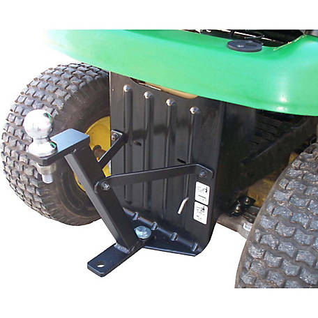

    This isn't my exact boat, something I found off the net but gives you an idea, very similar setup. That hitch setup is the identical hitch setup attached to my LT. Could the rise of the hitch be a problem?

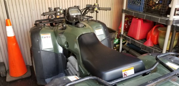

    Actually Horkn I did buy an ATV this past Monday, just haven't shared on FHC yet. 07 Honda Rancher 400AT. Long story short haven't had a chance to use it much but I love it! My first ATV, some getting use to. Initial thoughts are not sure it's the right fit for me or my needs. I need to give it more time and modify it to move some stuff around. It's got a hitch but it tucked way back close to the axle which makes it tough to use the wheel jack. Maybe I made a mistake and I could do what I want to do with my current LT or use that ATV $$ and get a beefy Garden Tractor to do all my needs. Again with all that said I really need to give the ATV more time, it just might fit in nicely, but the thought of maintaining one machine is nice as well. Pic of the ATV I snapped in the shed, not a great pic sorry!

    Yes. Just as having the hitch further back puts more leverage on the tractor, so does having it higher...the closer the ball to the rear axle of the tractor, the more weight it can carry before lifting the front end. A small change in the distance can make a big difference too.

    I just laughed looking at your pictures, I think we have the same boat and we definitely think alike. I did the opposite in one respect, I was going to buy that exact hitch but figured I would try without it first and see what happens. You could be onto something suspecting the hitch, while it raises the tongue which helps shift the weight back, it is also moving the ball further away from the tractor axle which could be making the leverage to lift the front of the tractor. The way mine is has a major downside, the ball is lower than the winch will go. If not that, I would take a good look at how the boat is sitting on the trailer, sounds like the bow stop or whatever it’s called is too far forward and all the weight is going to the tongue. Possibly set up for a longer boat than you have? You want some down weight but not so much that it’s putting all the weight on the main beam.
