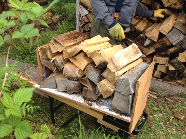

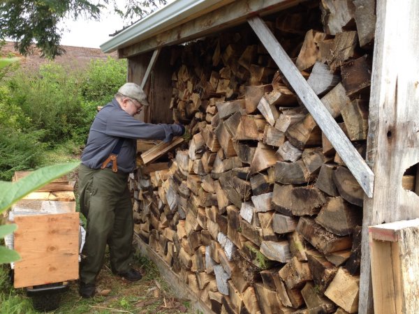

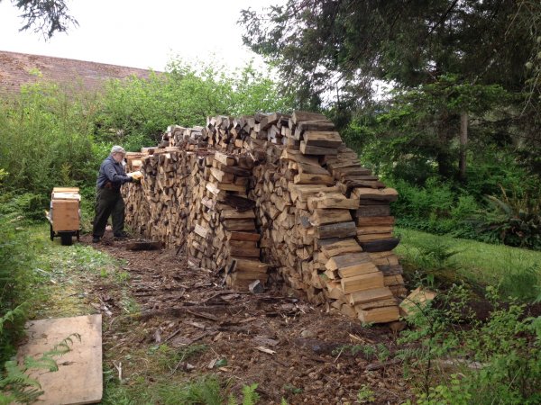

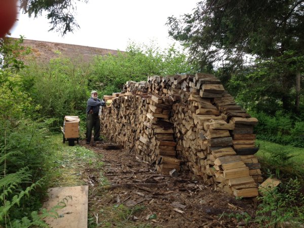

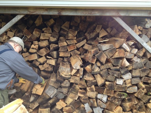

    In 2018 got into a gold mine of Yellow Cedar so have been putting under cover as space becomes available, Yellow Cedar can sit outside in the rain for years an not rot !

    Nice going… good looking stacks…

    Looks good for being css in '18?

    That'll make some proper BTU's!

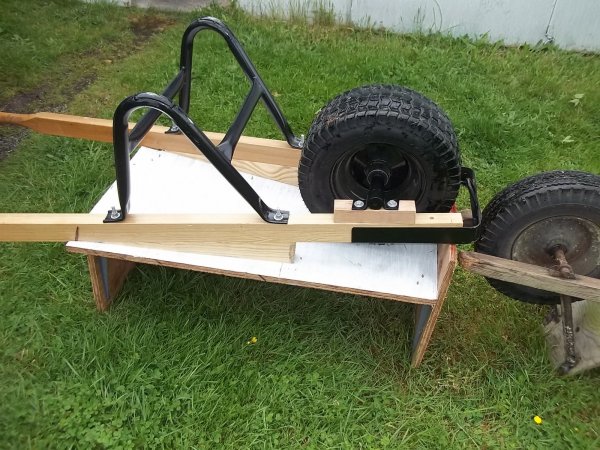

    And I like the custom wheel barrow mods! :thumbs:

    The custom wheel barrow makes for easy wood moving!

    Love the custom wheelbarrow btw. I have a wheelbarrow chassis hanging around. Maybe ill do something similar.

    Yes the railroad ties were made from Yellow Cedar , you can see some split in half on top of the wood pile.

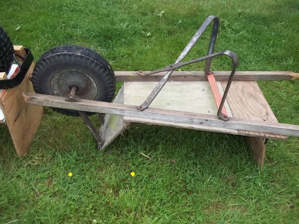

    Did you just replace the tub of your wheel barrow with plywood? Thinking about modifying my own nice job

    Yes just removed the tub and added a 2x2 spacer under the axle and wheel.

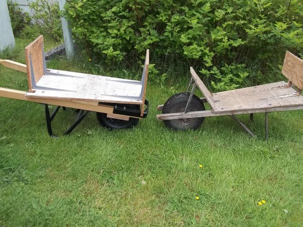

    I was at Granny's moving some wood today and got you some better pictures of 2 different styles.
    The one on the right is the first one I made. It is more stable but because the wood is back off the wheel, it takes more effort to lift and move around.
    The one on the left is a little top heavy and not as stable, but with a lot of the wood being over the wheel, it takes a lot less effort to move when loaded up.

    pretty nifty there Allan. I like the idea of it over the tire. Maybe ill remodel one of my two wheelers for that purpose.
    And we thought they were just shelf brackets! 1.9 thumbs up! :thumbs:
