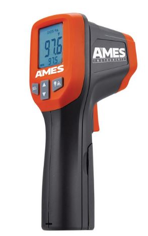

    Marvin, I have to ask if you've checked the temperature of the stove and flue with anything but the temperature gauges that are used on the stoves?
    Perhaps used something like this to compare temperautres?
  20. Marvin
    Marvin
    Mar 31, 2018
    2,268
    15,294
    Huntingdon, Pa
    I have not. I dont have an IR thermometer. Perhaps it is time to invest in one.
