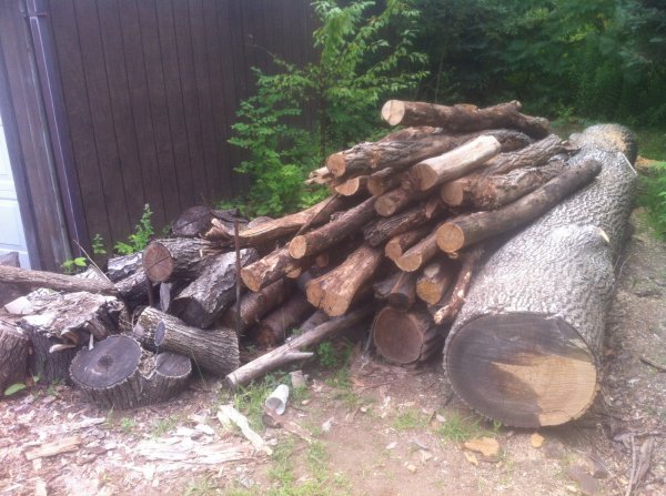

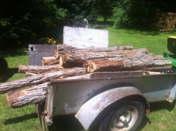

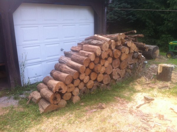

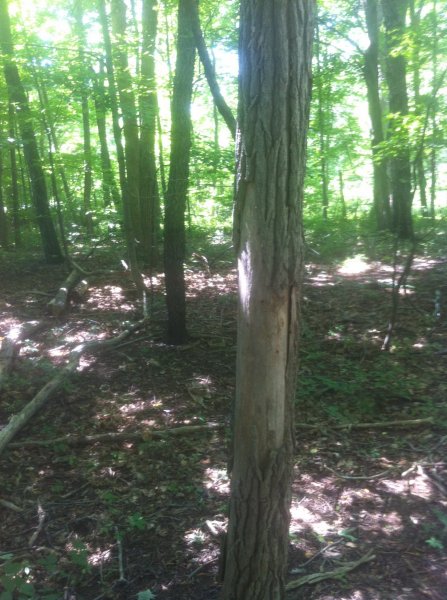

    My BIL and I were supposed to work on some more walnut today but he backed out. So I worked on my own supply a bit. Decided to add some prime BTUs to the stacks after all that pine. :)
    I cut down this little dead 8"er, and grabbed another smaller one I cut up earlier too. Probably a little under 1/3 cord. Cut up the bigger pieces and added the rest to the pile.

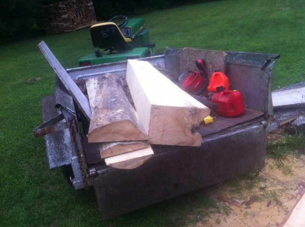

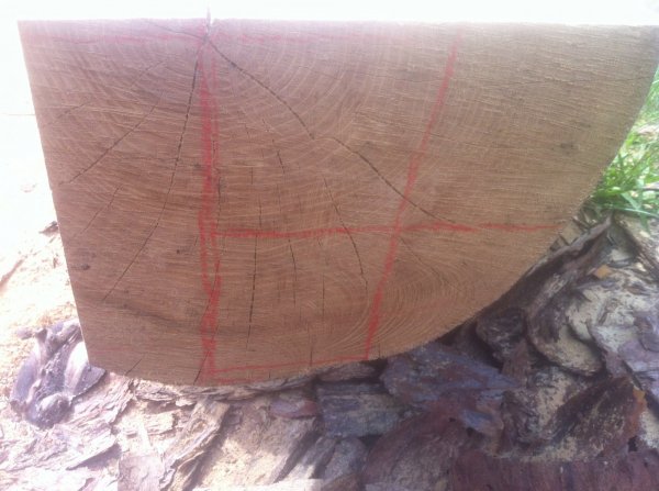

    I also milled the larger of the 2 locust logs that I tried to grab last weekend. The dark spot the I thought might have been some decay was totally gone - guess it was just wet! :thumbs: I'm going to get a beautiful 9x9 cant out of it, and some generous slab wood to add to the stacks. :)

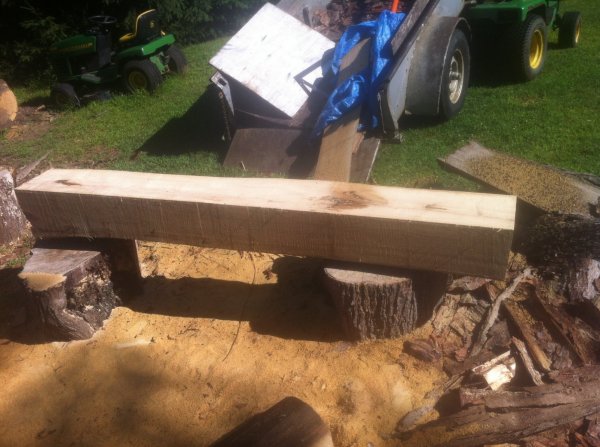

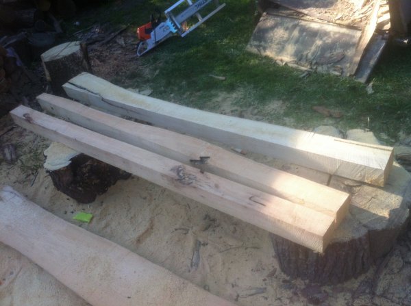

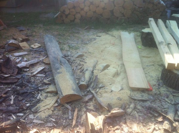

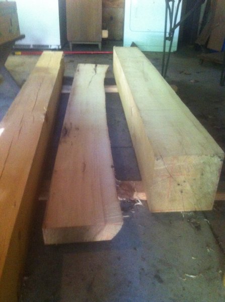

    I got the other piece of locust out of the woods after work yesterday. The quality was a lot lower than I hoped after seeing the first cant. There's a couple big ugly knots, and the top 1/3 is actually 2 pieces grown together. So, this piece may never be fine furniture, but it might make a primo pallet for stacking some firewood. :thumbs:
    I got to work on that today. There was a fairly clear piece on the one side that I slabbed off first; that piece might become the new inside wheel fenders for my wood trailer. From the remainder, I made 3 4x4's for pallet skids.
    Final yield from both logs - 3 4 x something pallet skids:
    9x9x7' beautifully clear cant, and a 2.75" slab that's pretty decent for about 5'. (on the right - on the left is some red pine)

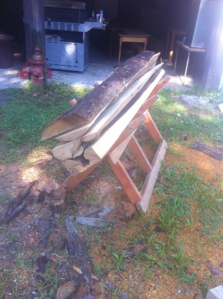

    I'll probably saw a couple of decking boards from some of the thicker slabs, and the rest will be firewood:
