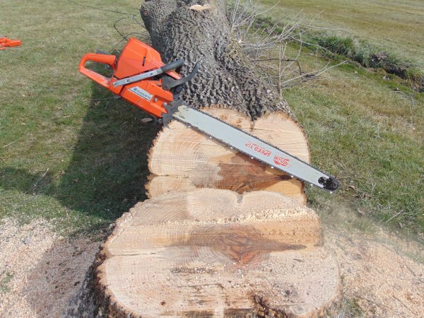

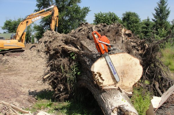

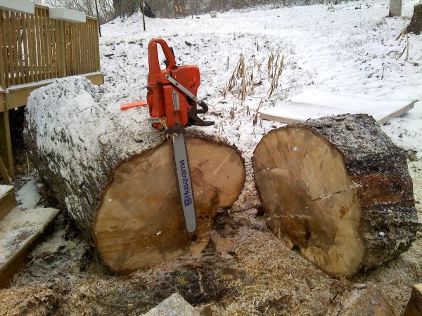

    I found myself in this situation a while back. I started getting into craiglist finds that were very large. Longest I had was 2 24" on my 394.
    I managed BUT, on the very largest sometimes the cuts wouldn't line up perfect etc. So I found a deal on a 36". Comes in very handy! One cut and done.
    But until you mount it up, you don't realize how bar heavy and a pain it it to wield. I'd say a 28 or 32 would be perfect.
