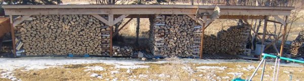

    What are the dimensions of your woodshed Bogy ? I know you have said before I believe but I don't recall. Also how many cords does it hold ? I think I may try to get one built this summer if I can find the time.
  12. bogydave
    37,217
    9'-6" deep, 48 ' long , 7' tall on the low end , 8-1/2' on the high end
    roughly 21 cord

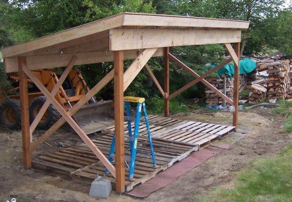

    Some Pictures:

    Dave the more I've thought about building as shed like yours with 3 bays the more I start to think about the varying wood species I come into and want to burn.
    In your case all you get is birch right?
    Problem here is I go from shoulder season - to 20's to 70's to 40's to teen's to 50's - more I think about it having segregated stacks with tin makes more sense for me anyways.
    I'd hate to be moving wood around to get to oak & hickory with a pile of gum in the way.
    I plan on doing something more permanent than my current lay tin on what I'm going to burn stacks
  14. bogydave
    37,217
    I had spruce when I first filled it
    do narrow front to back with one wood type.
    Center section is 1/2 spruce, 1/2 birch:
    (could stack 1/3 1/3 1/3 of different types. just some do some cross stacks)
    A 2X4 top to bottom of each row to separate types might work
    basod likes this.
  15. bogydave
    37,217
    Another thought, which I thought about doing.
    Work from the back side to the front,
    stack the oldest wood in the front row first. Newest wood in the back
    Then when burned oldest wood is in front row.
    Working back to front to fill a section works now that I'm caught
    up & empty a section each burn season
    Then re-fill it with wood all C&S about the same time.
    Also some might need to make the front & back row have more (some) shoulder season wood,
    Center rows for Dec & Jan the higher BTU wood (coldest months)

    Looks like that overhang addition in the front you put in gave you another 2-3cord of capacity.

    I see your main posts are out of the ground. How are they mounted Dave.
  18. bogydave
    37,217

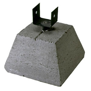

    See the concrete pier block at the bottom of the picture ?
    I dug a 12" (+/-) hole down to gravel, filled & compacted the hole with gravel to about a foot from the top
    Then buried the concrete pier block to where the top of the block is ground level for each corner post.
    They freeze in , in the winter & hold the roof down in the high winds, & I also took care
    to make sure the edge of the pallets are on top of them .
    That way the weight of the wood helps hold them down too.

    That addition gave room to keep 5 rows deep dry.
    Thinking about adding 24" overhang to the back, one more row of dry wood. :)
