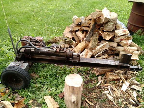

    Then I split the shoulder wood I gathered- pine and box elder. Probably a face cord worth. Then back to home for lunch. IMG_20150525_085622947.jpg IMG_20150525_085642143.jpg IMG_20150525_091329120.jpg IMG_20150525_112647790.jpg IMG_20150525_112701030.jpg

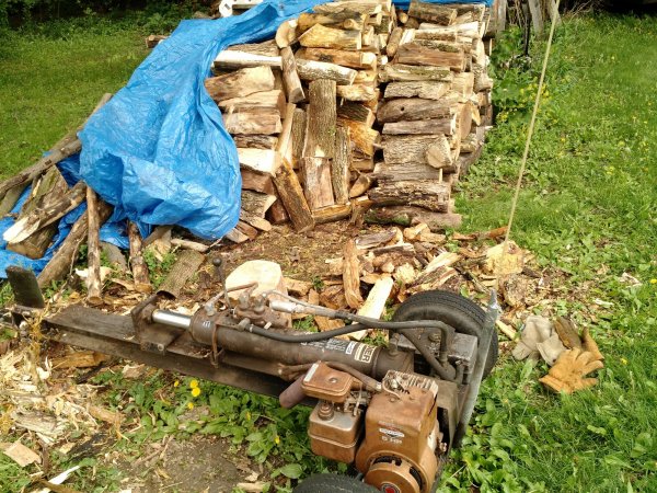

    Notice my elm chair? It's no milk crate with a cushion, but it worked, until I split it. This splitter doesn't work vertically, but my buddy bought it from our friend for $200 this spring. It started on its first pull today.
    I didn't even start the ATV as I had to get home so I could rest my pancake with bacon lunch at noon. The second row in from the right was the split elder and pine, but I split a few of my mid grade wood rounds too to the left of the shoulder wood, and a couple rounds to the right as well. IMG_20150525_115146802.jpg IMG_20150525_115155599.jpg

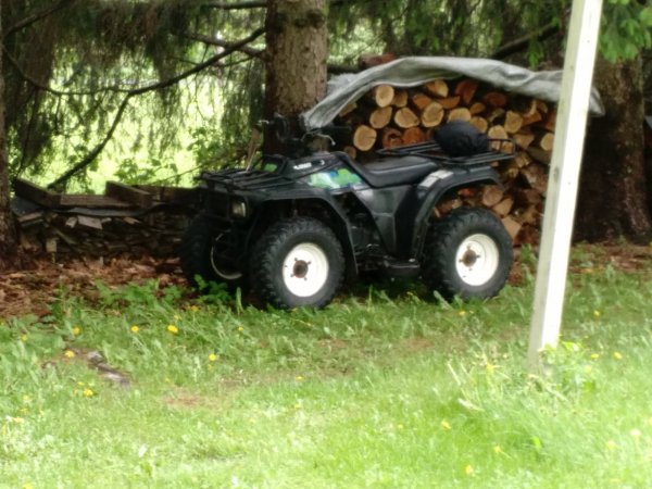

    Great pics. Ill have to go searching for morels here. Quad looks saweet!

    That splitter is probably as old as I am, but it started on the first pull.
    The quad works great, it just has a couple of quirks, mostly due to the carb needing a little work, but it's stone dependable, which is why I got it.
    I got a cover for it, it fits great and covers all the way down to the wheels.

    I like the look of the old splitter, solid and dependable. You can probably get another 10 years out of it.
    How do you get the larger rounds onto the beam?

    I have the same splitter made by didier. Mine is every bit of 30 years old and just changed the original motor 2 years ago. They are a nice little stout splitter just low to the ground!

    I bet that old splitter would be chugging along in another 20 years without doing anything but changing the oil, a plug, and not much else. We plan on upgrading the splitter with a bigger newer motor- my buddy has an 8 HP Tecumseh laying around, and a larger hydro tank this summer. We just have to get my wood split for next winter and we can get working on that project. We will raise it up higher, possibly make it a horizontal/ vertical too.
    Getting big rounds on it is simply s heavy lifting exercise. That's where it's good that the splitter is low now. I Should use a car wheel ramp, or even a small plank to make a ramp.
    Those big hickory rounds are heavy.

    Nice work man , looks like that little short bugger is getting the job done , maybe if ya have a set of car ramps laying around you could get it up to a little better working hight

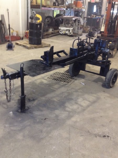

    This is very similar to the didier splitters and about the same age. 15 inches from the ground to top of beam is way too low when you want to split 10 cords in a weekend. Raised it to 27 inches added 3 1/2 feet to tongue and a wood catcher. Side trays so you don't wore much about throwing wood on and it falling off. Going to do a hydraulic lift soon. It's a mongrel but it was free and in rough shape.

    image.jpg I finally made it work. There's the mongrel. Kickstand has since been updated to a fold down stand and hitch has been lowered so it tows level.

    That's about what I was thinking. Easy to do, but it will really help in using it. Did you add a bigger hydro fluid reservoir?
    Splitting when it's over 60°, the tiny reservoir that's on it gets very warm, and the vented cap goes off like a tea pot at boil. That tells me it needs more capacity to cool the fluid off.
    I mean, it gets a workout from hickory, elm, and crotchety box elder, but it still did it.

    I've never had it overheat. It's probably a 2 gallon tank on it and for the last 10 years or so it's been fine. Usually cut and split in the fall but when it runs it's usually 8-10 cords straight out of splitting. I own it with my cousin who splits a little bit at a time all summer long. He doesn't complain but would if there were issues.
