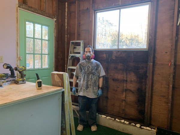

    Hi all, i thought i would share my moldy laundry room story. The room has a washer, electric dryer and an open staircase to the basement and pull down stairs to the attic. not much else. Never realized humidity levels were through the roof. It is an unconditioned room meaning no heat, ac or dehumidifier. I was having a problem with condensation on the walls, ceiling and windows. Then it happened, and fairly quickly. mold spots all over the room. first i had to get rid of the ceiling popcorn paint. luckily the mold was only on the popcorn for the ceiling. then the walls came down, some studs replaced, window sill and all window wood replaced. i coated the room and fogged with concrobium - a mold abatement product. rebuilt the walls and I just got new insulation up tonight. the room now contains a dehumidifier and there has been no condensation or moisture anywhere. tough lesson learned. It's finally ready to put up greenboard, and i hope my progress pictures show up nice here.

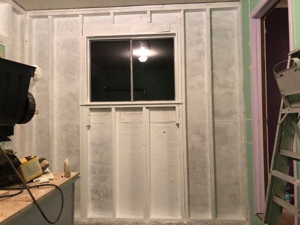

    in some of the pics, the studs are covered with zinsser mold killing paint, hopefully for good measure, but the dehumidifier is staying on in that room from now on. I forgot to take pics of the concrobium fogging which is a shame because that was the coolest part.

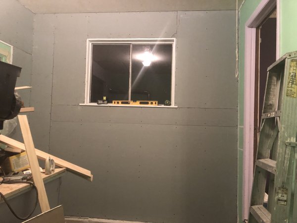

    211

    i forgot to add the problem was mostly the ceiling popcorn and the 2 outside walls, i did not tear the whole room apart and the ceiling is saveable and the inside walls are too. if anyone spots anything i did wrong please let me know before i go ahead and put up the greenboard. humidity is holding at 29-32% now with the dehumidifier

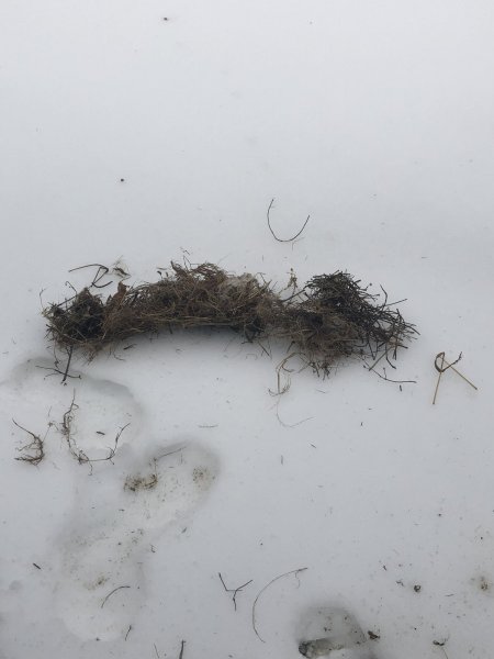

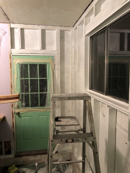

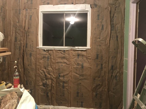

    I have all the sized of mud knives and today i bought a mud pan. I believe the cause was a birds nest in the dryer vent that went undetected, however that was not the only cause. It is a completely unheated unconditioned room in the winter and summer. if cold air leaked from the attic it would be the same temp as the cold air in the room. The moisture comes from the basement, which has an open stairwell up to the laundry room. since the basement is underground, i believe it stays a tad warmer than unheated upstairs. thus condensation. I thought about a vent van, even one on a humidistat, which i can definitely do, but i went with the dehumidifier to warm up the room as well. Back story is this probably happened in may when i was sick for a few months and didnt notice much, such as the dryer vent plugged. I'm all better now and making a lot of progress. Heres some pics of today's events!
    the last pic is the birds nest. the flapper on the dryer vent was stuck open. I fixed the whole thing and cleaned it good with a brush, leaf blower trick and new flapper.

    by the way the new greenboard (grey in the pic for some crazy reason) is raised 1/2" off the concrete stool, which it wasnt before. I also changed out the double foil faced insulation to single faced kraft r15 batts. i intend to also seal the concrete stool under the wall with a good sealer
