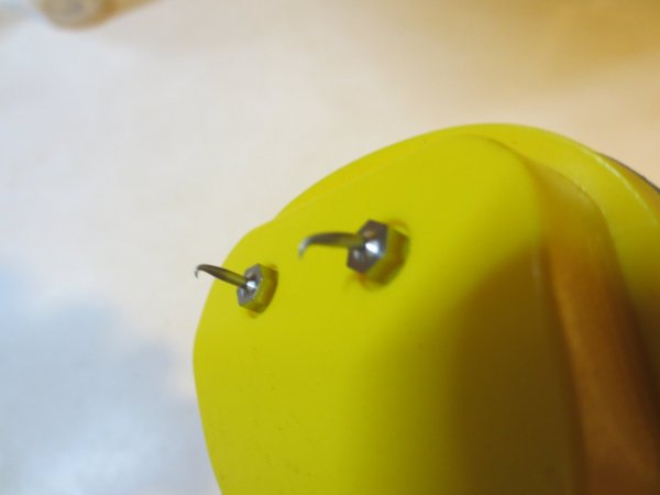

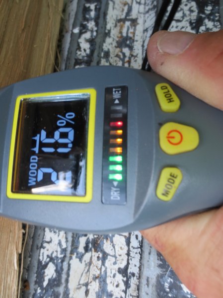

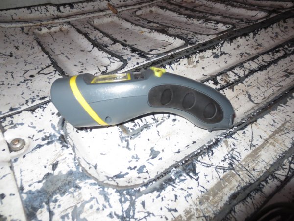

    Ive thought the same. My first one i paid $20 (not sure what that converts to in Pounds.) My current one i paid $35 IMG_3032.JPG IMG_2904.JPG
    I learned a valuable lesson...dont jab too hard into dead black locust! IMG_2988.JPG
