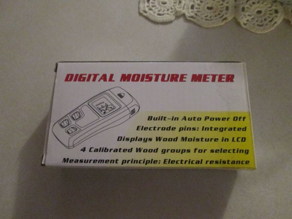

    ...Are they worth it?
    I just bought one off of Amazon for $35. My buddy that operates a portable sawmill suggested I get one.
    However, I’m a little concerned about some of the readings I got tonight. Everything I tested, except for a few logs here and there, was in the 12-15% moisture range. Here is what I tested:
    Wood (when cut)
    White ash (nov-feb)
    Silver maple (May)
    Sugar maple (May)
    Cherry (May)
    Red Oak (April-June)
    Mulberry (April)
    I just don’t understand how the red Oak and the dead, white ash are testing about the same.
    Also - any resource that shows optimum moisture by species, or is there just a general moisture-% that needs to be achieved for curing?
    Thanks for the help in advance!

    This is the one I bought

    I know you need to check a fresh split, so take a split and split it again to get a true reading in the center. Outside will always dry first and give false readings.

    If you're testing the surface then everything you test will be the same.
    If you want to test the inside of a piece of wood then you have to split or cut it open and measure the inside.
    For firewood ( and even boards ) the center is your target and what takes forever to season.
    Testing the surface may be fine if you are planning on painting the wood.
