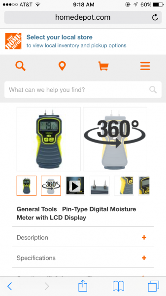

    IMG_5385.PNG Are these things worth it??? I have split about 7 cords of wood in the spring and the past year I have tried burning wood and it's smoldered and was wet but finally have it drying and seasoning outside correctly. Will this 100% tell me that the wood is good to use with its moisture content?

    I have one and it has come in really handy, I don't use it as much anymore but I'm in a different situation now. If you are in the situation you described they are very useful. Keep in mind they are preset for reading moisture at a specific temperature. I think its around 75 degrees, so if your checking wood in the middle of winter its best to bring it inside for a bit. And always check on a fresh split, the inside will always have more moisture then the outside. The meter will help you figure out what is ready now and what isn't.

    Always measure on a fresh split, you are looking for 20% or less moisture content.

    20% or lower moisture content or less for good burning wood ok perfect. Are you saying all the split wood i already have split and seasoned isn't a good way to check for dryness? I can or should only check as soon as I actually split the fresh wood ?

    The comment about a fresh split wood means that when you check the moisture reading, take a split that has been seasoned and split it in half and check the moisture content on the freshly split side. The reasoning is that the interior of a log will have more moisture than the exterior, even if it's been "seasoned".
