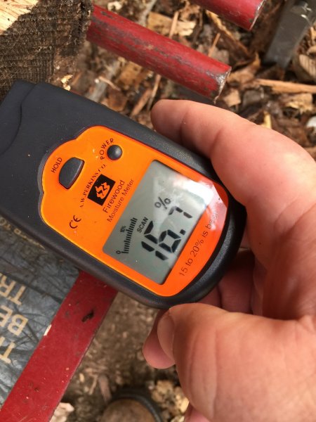

    The attached pictures show the same piece of wood. This is red oak, cut in late 2017 (2 years old now) and left on the ground, in the round, in the woods. I picked it up and brought it back to the yard to split and stack. First photo shows the MC% of the end of the piece, second is the MC% in the center of the fresh split. This informal test, more than anything else I've seen, proves that rounds left unsplit do not dry properly unless they are kept indoors or dried by mechanical means (i.e. kiln or dehumidification). I took two more photos on a separate split and they measured 16.0% and 32.4% respectively.
    Unfortunately, this is part of my wood for this winter. I put it at the back of the shed near the bottom, so it will have another 4-6 months under cover to continue to dry. Will be interesting to see the MC% in late March or April.

    I hope all the rounds have been split.
    And, try to give it as much air circulation as you can.
    Hopefully, you won't need it until the end of the heating season.

    March of last year we had a blizzard drop a huge red oak (24" DBH) across our driveway. I CSS soon thereafter. Last summer i took a heartwood split (16 months seasoned) the size of a 4x4, split it and MM said it was still over 20%. Burned it in my firepit later that night and it sizzled a lot. When i joined FHC in February a didnt believe oak took as long to dry as they said. I was then finally convinced. Wood in the round dries very slowly. Ive seen a few members here season in the round but they live in VERY dry, low humidity climates.

    If your rounds weren’t sitting on the ground, your findings would be significantly different. Not saying it would be as dry as you want thoigh
