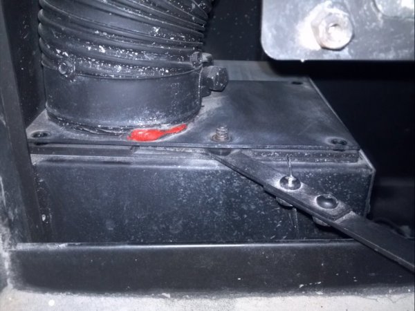

    out of necessity I had to modify the air intake in the NZ3000.....even with the draft control WIDE OPEN, it was choked down so damm bad that the fire would almost go OUT when the doors were shut, and also made the glass get super black.......wasn't enough air going through the airwash system to keep the smoke off of the glass.....with the mods I made, it works very well now. I still have to make a modification to the doors when I get time.......

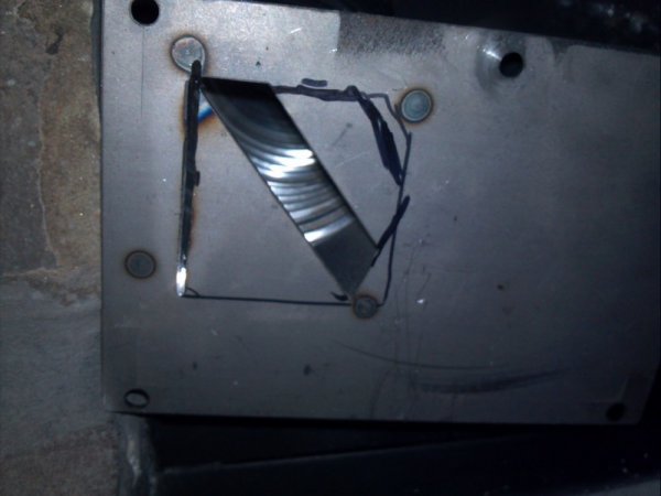

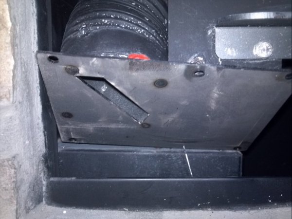

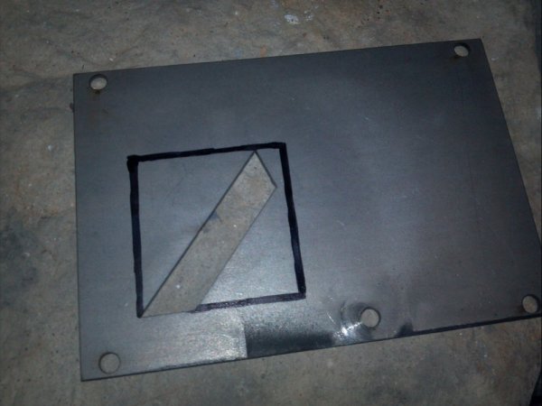

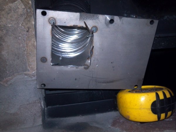

    Ooops.....sorry guys, thought this was an EPA stove. My bad...:emb:
    LP, I had to literally take the draft control box apart as I was convinced that something was almost totally blocking off the intake air. Turns out I was right, it was a factory installed baffle!! Literally let next to ZERO air into the firebox. I'm convinced that Napoleon put it in there to get the stove to pass the EPA regs or maybe to make the stove look like it had a really long burn time. Either way, it was almost totally IMPOSSIBLE to shut the doors on the stove as it would almost totally smother the fire.
    here's a before/after look at the baffle I modified.....
    before mods.....
    After mods.....
    Now, I do NOT recommend that anyone modify their stove unless they have a clue as to what they are doing......if one was to perform this mod and leave the stove unattended in the "wide open" setting, they may get an over-fire......but I can tell you it most certainly helped this fireplace perform way better than it did when we bought it...

    Got ya.....That is quite a difference in size. I'm not going to do anything with mine until I see how she does when I can open it up and let it stretch it's legs in some nice cold weather. It's not much of a problem just a little in the bottom corners and that's just on the long burns so probably a non issue. I'm pretty happy with what I see so far.
