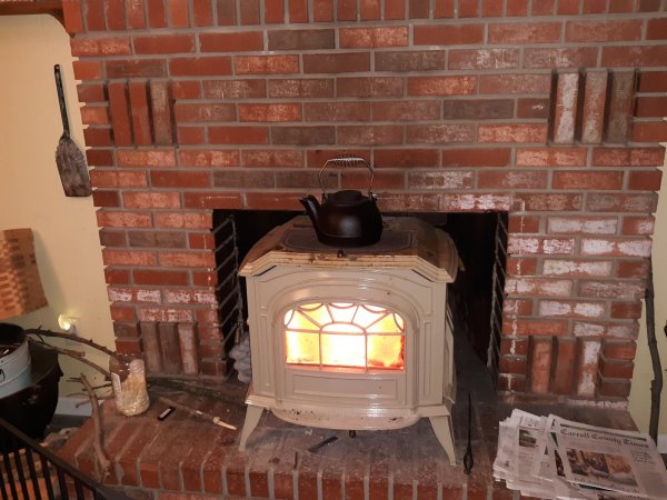

    20191108_184312.jpg So after a few years of my FIL constantly fixing something on the stove I may have him talked into getting a modern stove. A few years ago I took over the firewood at are place and have been bitching ever since about the stove needing loaded every 4 hours.
    So my question is what are some good options to replace this old stove with.

    Its a good stove. FIL sade when it was new 8 hour burn times were normal. Ares has close to 30 years of every winter use and is showing its age. Theres just better stoves available today.
    If I could find a brand new one hidden in a warehouse I'd just go that rout and skip all the EPA crap a new stove brings with it.

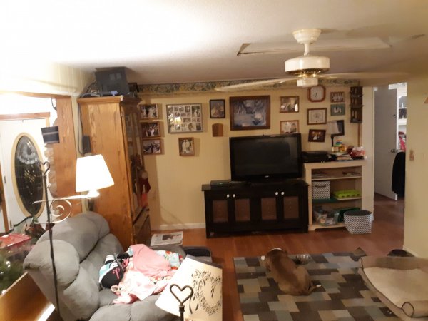

    House is around 2300 square foot. But we close off the hallway to the bedrooms at night. I'd rather grab another blanket then be to hot when I sleep.

    If your FIL likes the look of his old stove but knows that he needs to update it he might consider Jotul stoves. They share the same look with VC.
