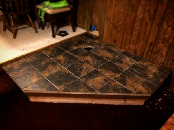

    I like the colors! Nice work

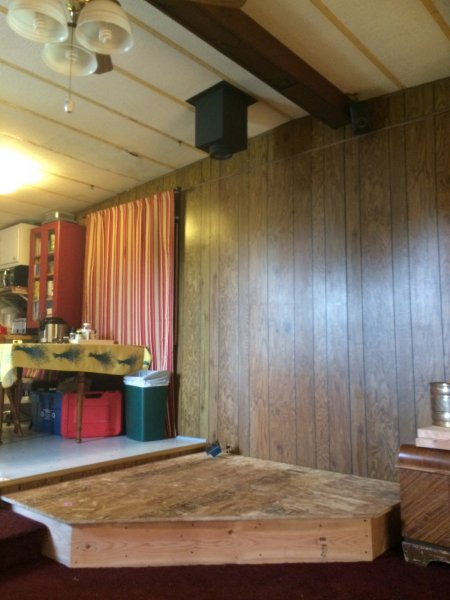

    Great job Sequoia :yes: looking real good, not trying to mother hen, but be careful of clearances to paneling in back...

    I appreciate that I'm installing a Blaze princess ultra made for clothes clearance installation

    I'd probably still put something on that wall.
  12. TurboDiesel
    16,199
    97,210
    x2
    even just stand a sheet of concrete board there

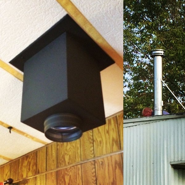

    The stove will sit at a 45 degree like an alcove setup. The back corners of the stove will be 8inches from the wall and back of the stove will be at least 12 inches from back corner of hearth. Plus I'll have a blower on the back which acts as a heat shield and it will have side shields. Based on your collective knowledge, will this be adequate clearance?

    I would base it on the last two posts,
  16. HDRock
    17,252
    60,393
    Go by the manufacturer specs.
  18. HDRock
    17,252
    60,393
    looks like in the manual, a reduced corner installation, your sides are two inches farther than required 6"
    in the mobile home you are required to have a outside air kit also
