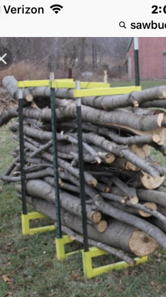

    Quick branch buck, 3 cinder blocks + 6 2x4’s everthing gets loaded in then cut in 1 shot... anything too small for that branch buck is campfire wood. Easy!!!

    basically this, each cinder block gets 2 2x4’s like a v shape. They just sit in the cinder blocks maybe 4 or 5 ft long each. Of course its not letting me load the pic rt now

    Whatever your comfortable with and feels safe thats what matters.
