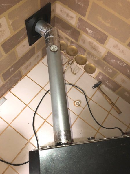

    Yesterday I cleaned the beast and had it cold for a couple hours prior to cleaning.
    Restarted and had a couple whiffs of lite smoke.
    Snooped more and laid on my back to get a good view of the seam in the long run.
    Sure enough I found a tiny pin hole in the outer jacket where the welded seam is.
    More foil tape.
    I will never use Simpson again....
    Sad part is the room air fan is sucking from the corner where the pipe runs and just sucks the smell up and blows it out the heat vent.
    But, as long as I don't smell it when I come in from outside I'm good.
    Not going to tear the vent all out...
    Been in there since Feb 2010
    A pix of the entire run.
    The choices of locating the vent were not stellar, as the location of studs in the wall, location of a downspout outside, location of a fake shutter....
    The stove had to go in the corner and I wanted good access to the stove for cleaning and any repairs in the mechanical cabinet without having to unhook and move the stove.
    The room is 16' x 25' so the small wasted space behind the stove was a non issue.
    Actually is useful to some extent....During the off season we stack the 5 gallon "Shell buckets" on the rear of the hearth and there always seems to be something else that finds it's way back there.
