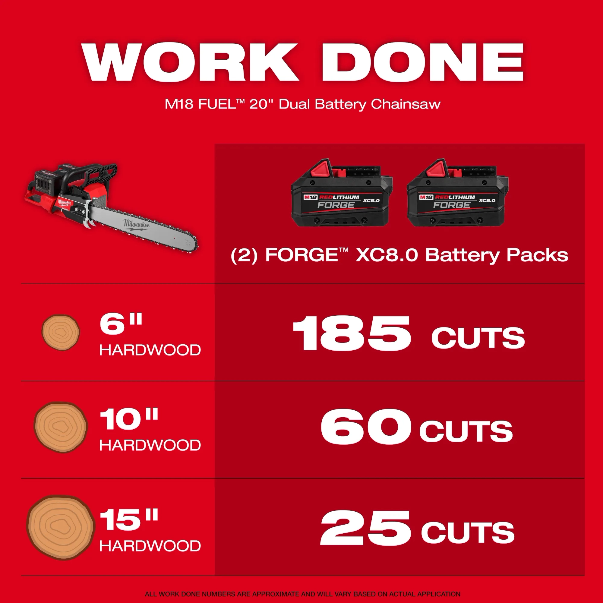

    25 cuts of 15" hardwood is where I am hanging up. My 501 does that and still has 2/3 a tank of fuel left.
    Makita will soon drop a backpack unit I bet.

    For most people/homeowners, 50 cuts through 15" hardwood with the two batteries would be plenty sufficient imo. Not having to deal with the fuel related issues of their saw sitting for months(year?) on end will definitely be a good selling point

    Its 25 cuts for 15" hard wood as it uses both batteries at the same time. Not 25 per battery.

    One pack is only 18V and to compete with 36, 56/60, or 80V tools, there's gonna be some serious amps involved which means heavier conductors in everything. The pack, the wiring, the motor - all of it. And being a chainsaw means that the sustained loads will not allow electronical witchcraft to cheat a bit and overload components for a limited duration.
    At least the dual packs on this unit mean that it's a 36V tool. But forcing dual pack operation has it's drawbacks too as now the packs must be of similar design & capacity, and ideally, age. Mis-matched packs just mean more trouble.
    And you can just about buy a complete 501 for what a pair of those XC 8.0 packs cost. ($400)
