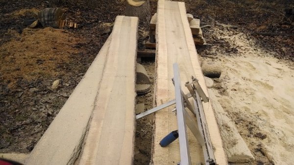

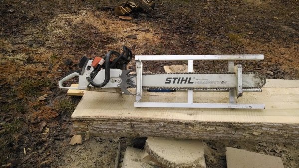

    I figure I'll try to get some more pictures of milling on here also. This is what I got done today.

    Very nice! Is that Ash? How will you be drying it?
    Have a woodworking project in mind?

    Poplar there. I don't know if I'll take it to the kiln or just stack it. The finish is rough with the chisel chain. I need to plane it down a little before sealing. Most of this in going to be raised garden beds.

    Nice job mdavlee, how thick are the boards you milled?

    1 3/4" those are. Going to try to get some 5/4 next.

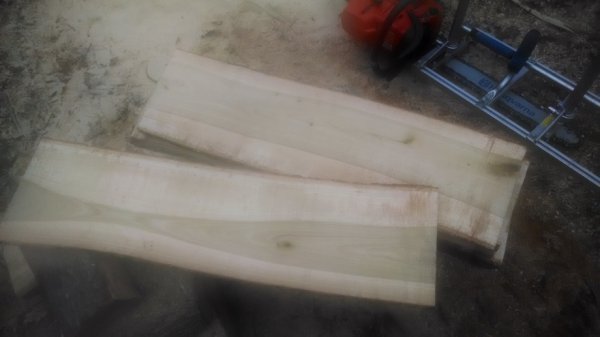

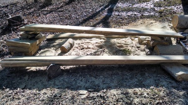

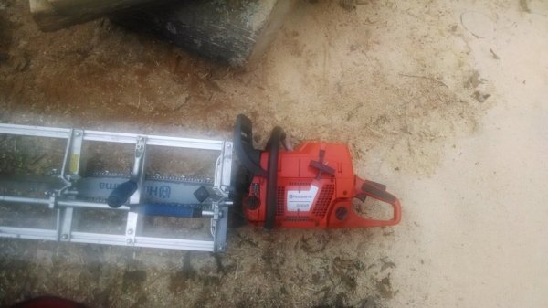

    Got 4 more cut today. I squared the log up with the mini mill and the 088. It worked good til it came loose and hit the mini mill with the chain. :mad:
    Did get 4 nice poplar boards out of it and semi skip square filed worked great. 006.jpg 007.jpg 008.jpg

    Great job

    For your info the 046 standard out put oiler barely keeps the 24" oiled milling. I'm getting the HO oiler for it soon. I forgot about it until I killed my chain for the short bar to fit the 088.

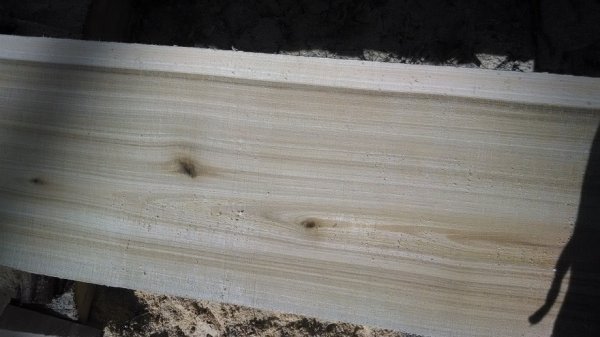

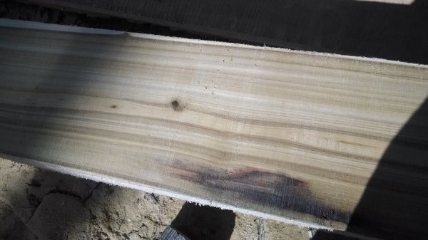

    Here's some pictures from today.

    Plus the rough sawn stuff will last a bit longer outdoors than planed stock,all things being equal.Sheds water better.
