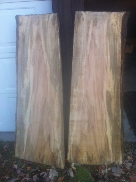

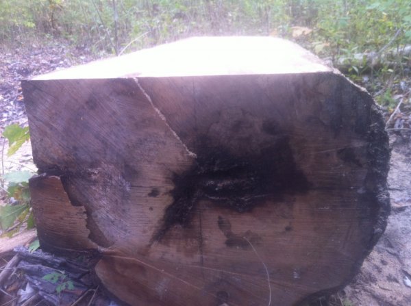

    I've sawn a couple like that. The 4' black walnut at my sister's had quite a bit of lightning damage - I think it might have been hit more than once. I've also sawn some maple with a bit of rot that was centered in the log; and that was much easier to deal with than the walnut, which had off-center hollow pockets in several places.
    If you haven't bucked your logs to length, that can be one way to assess how far the damage goes, and what it's doing in the log. In a large maple, I'll bet it's mostly centered. I just tried to "guesstimate" where I thought it would have been when I was marking the log.
    These days, I like to make my first cut right through the center, like you saw me do at the GTG. I do this mostly for speed. Once I make that inital cut through the heart center, then I can just set my mill to "slabbing depth" and saw the rest of the log in one long session. I don't think I'd go that way when there's heart rot, as you're likely to hit some dirt in there, and I sure don't want to resharpen after a single cut. So I'd take the extra time to saw it from the outside first.
    I think it will be worth it though - maple can do some really pretty stuff when it starts to turn, as long as you catch it before it goes punky. Don't be surprised if you end up changing your mind about what you want to do with it!

  6. unclefess
    unclefess Guest
    is that rot or just a bad picture ? :rofl: :lol::rofl: :lol::rofl: :lol::rofl: :lol::rofl: :lol::rofl: :lol::rofl: :lol::rofl: :lol::rofl: :lol::rofl: :lol:
