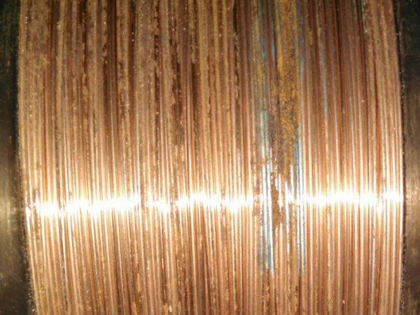

    If it's an older spool of wire it sounds like it may have some rust spots on it. Pick up a new one and see how it goes. Should be better unless the liner is loaded up too.

  9. concretegrazer
    concretegrazer
    4,429
    12,448
    Southwest MO
  10. Bret Hart
    Bret Hart
    1,059
    3,806
    Central NY
    There's the issue. If you don't use the welder much, stick with the 3 pound spools. Blow out the liner before you run the new wire into it. Might save you from buying a new $20 liner too.

    Bret Hart has pegged it. If you were running that spool through it for a while, I'd swap out the liner just to be sure. Cheap preventative maint.

    Its just like rods you need to keep them dry.

    Junk the wire! When you put a new spool on and have it ready, "don't laugh" spray it lightly with "PAM" the cooking sprayo_O…. Not heavy!!! It will help clean out the liner inside run out about 10ft of wire then go ahead a weld:cool:

    Get rid of the rusty wire put a new roll on and blow out the liner.

    Blew out the liner & with a new spool of wire she's running fine. welder.gif
    Thanks!
