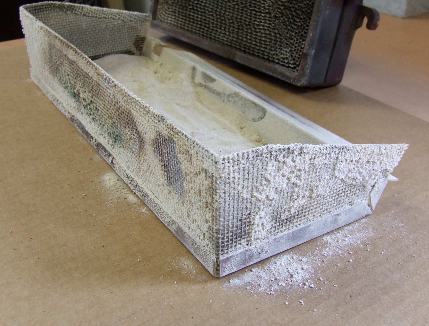

    The inconel screen provides protection for the combustor and will accumulate fly ash. If the build up is not cleaned severe clogging will occur (clogged Fireview inconel screen shown above) and the stove performance will drastically diminish.
    If you have a newer stainless foil combustor, you can do a thorough cleaning with a 50/50 solution of white vinegar and distilled water. Put the solution in a spray bottle and give both sides a good spritzing and let drain over paper towels, and/or foil pan. The vinegar solution is also great for removing any hard deposits on the inconel screens. Rinse with distilled water (ordinary tap water may contain minerals and chemicals that may have adverse effects on your combustor). After rinsing, let dry and put back in your stove.

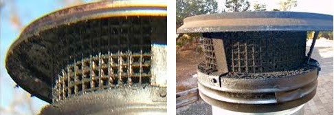

    Mid-winter is also the time to give your chimney and chimney cap a check, particularly if there is a screen around or under your cap. Build up of soot at this vulnerable point can inhibit draft flow, resulting in back puffing or reduced performance.
    A clogged chimney cap will restrict air flow

    It looks like you took a pic of my cap from last year. Good reminders, thanks.
