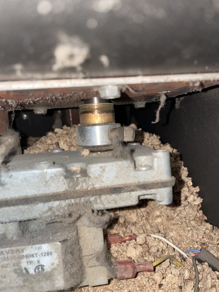

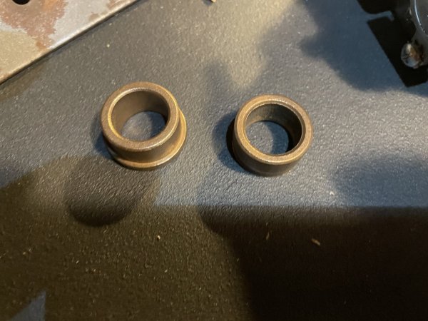

    This Hampton GC-60 FS is just like the M55 and after 7 years, all the bronze auger bearing impregnated lubrication dried out so the auger stuck to the bearing so when the auger motor turned it turned the auger with the bearing and the top of the bearing flange ripped off! The auger started falling through the stove and made a gap so half of the pellets fell into the back of the stove! The avalanche of wood pellets pressed against the auger motor wires until one broke! Also the increase in starting current wore out the magnetic hopper lid safety switch!
    Luckily I had a new Enviro auger bearing on me! They are $68.00 for a pair!
    I also installed an upgraded new S902 - 2 RPM ball bearing auger motor with needle bearings on the output shaft for good measure. :)
    Therefore it may be a good idea to remove this bronze bearing every 5 years and clean out the inside and soak it in synthetic bearing oil or light machine oil for 24 hours to replenish the dried up lubrication???? That will keep the pellets flowing in the right direction??
    See pics of old and new bearing below. :)
