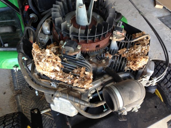

    I put the JD X530 up in the back shed in early March and brought it down today to do spring maintenance. When I hopped on I saw a mouse run away from the front of the tractor. This is what I found when I got down to the shop and opened the hood. I had already cleaned the flywheel off. I started at the top and kept pulling parts off and vacuuming. At the end a long screwdriver and the blow gun got rid of the rest. Fortunately the only thing they chewed was the outer foam air filter and I had a spare. When I put it back I put several dryer sheets on it to hopefully keep them out. I also added a bucket trap with peanut butter.

    Good job on catching that. Most people would have ran it like that. Then they would have blown a head gasket or worse.
