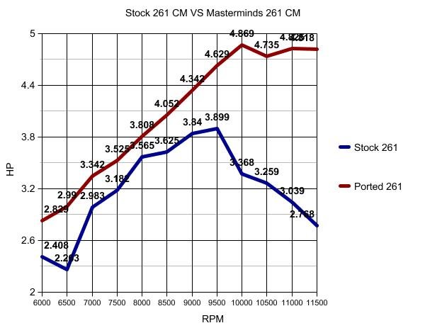

    The guy makes a chart to show the curve of the power (both torque and HP). He already did a stock 261C-M and Randy's personal 261C-M. The proof was in the chart. Randy's ported 261C-M not only produced more power, but over a much broader range. :thumbs:

    Here is that chart/graph. I forgot to do it
