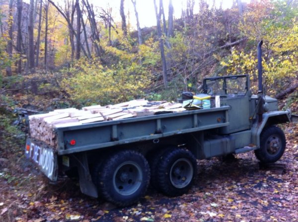

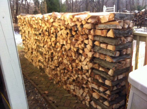

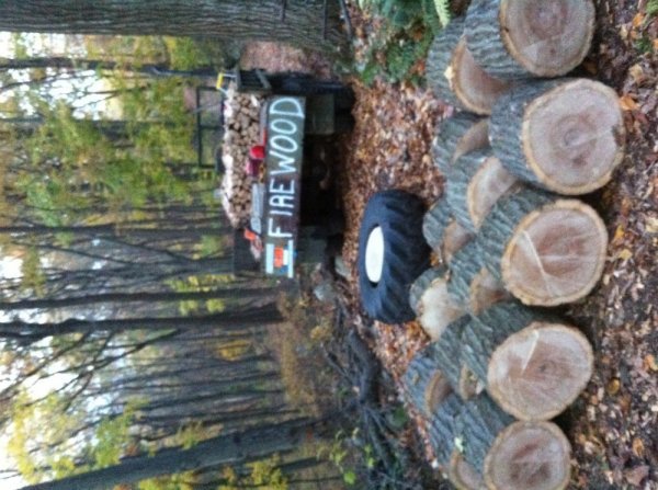

    as much work as it is, i stack a full cord in the truck before i go deliver. i also stack the first load a new customer buys for free in order to gain trust. :ithappened:
    sorry, i am picture happy today.

    Man, I love that truck.
    That's a good practice when dealing with a new customer.

    it may be good practice, but it sucks! it takes me every bit of an hour to unload and stack that cord. i feel they do appreciate it tho.
    i dont really want to be selling wood any more...

    Yeah, I couldn't do it, but I know a guy older than me still doing it.
    An hour to stack a cord?
    I'd be dead at that pace.:hair: I'm good for about 1/3 cord an hour.:thumbs:
